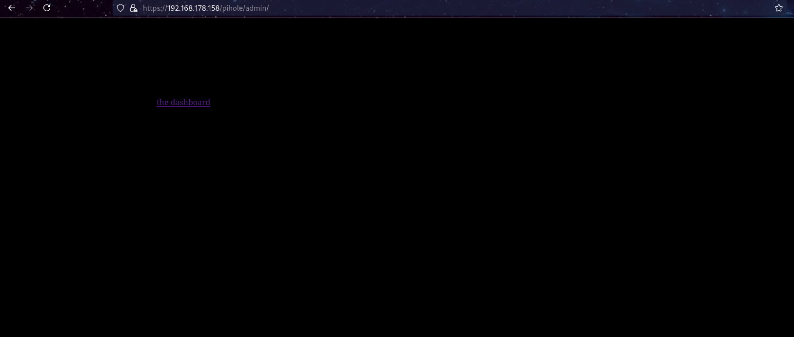

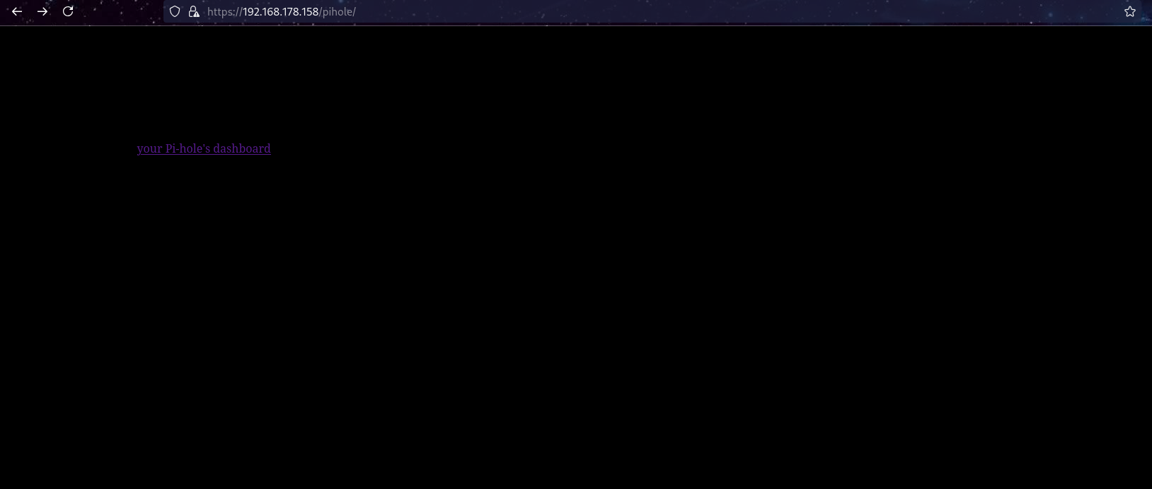

I am just seeing the links present on the Page and no other content.

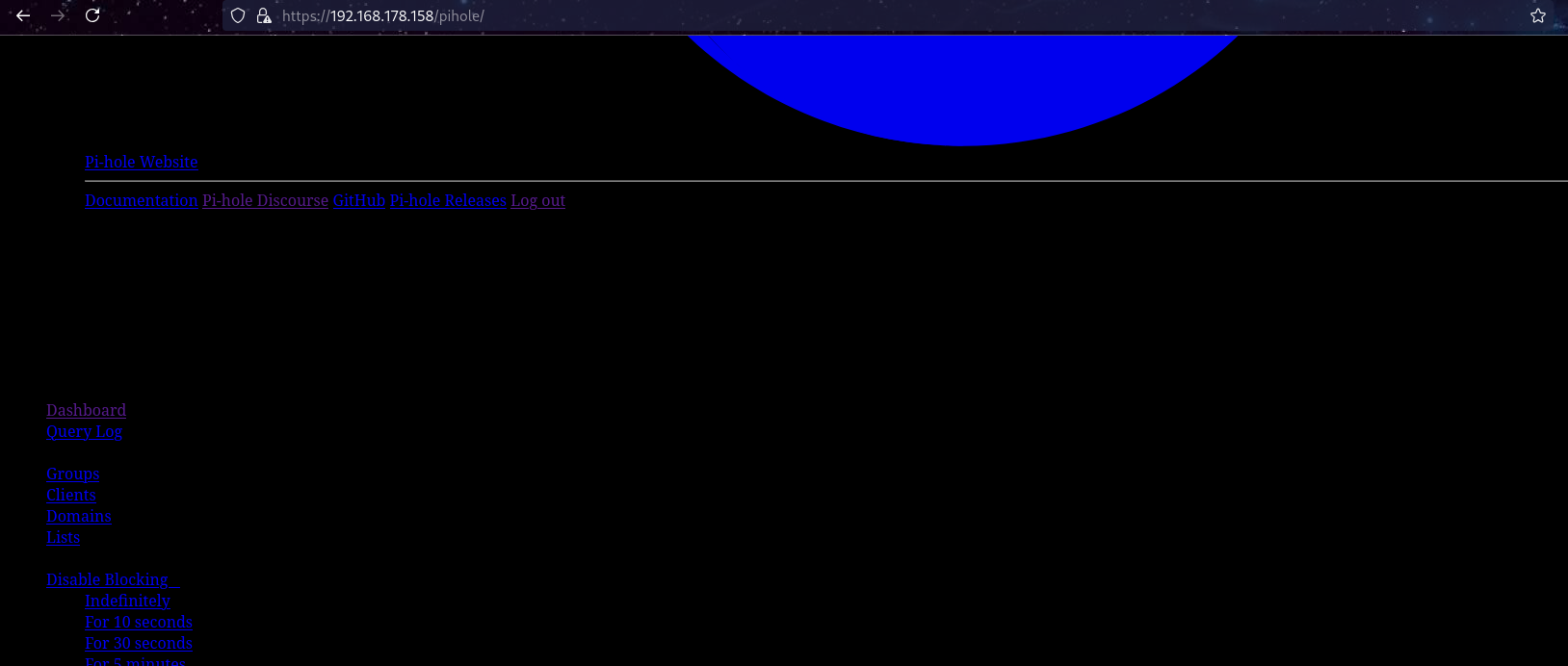

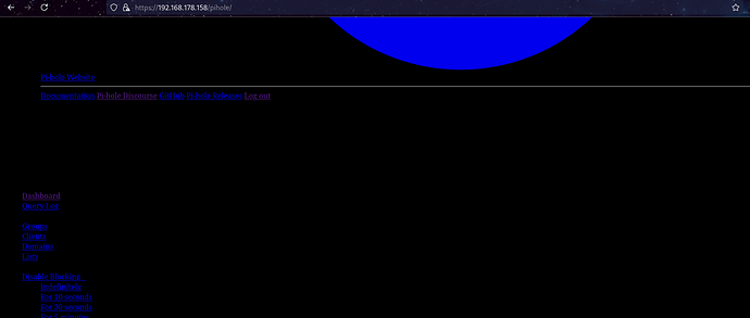

When using:
location /pihole {
        proxy_pass http://localhost:8080/admin/;
        proxy_set_header Host $host;
        proxy_set_header X-Real-IP $remote_addr;
The behavior is:
All the links will be broken and try to point to https://192.168.178.158/pihole/admin/network for example.
