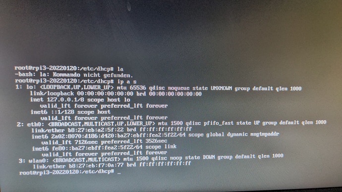

Hey guys, I have no clue whats going in here. I'm using pihole as dhcp, DNS and of course for adblocking. Its a pi3b with debian latest (i think bullseye).
Everything was working well till now, when suddenly all of my devices lost internet connection. At first I thought it would probably be my provider due to maintanence or an error but my fritzbox showed internet access was just fine.
So i tried the pihole web admin panel but getting an error. I tried to SSH but not cli statet not reachable. Pinged the IP, 100% package loss. So I restarted the pi (old windows trick :stuck_out_tongue_winking_eye: ) but nothing changed either. Lastly I pluged in a screen and keyboard and restarted it again. Its booting, I can login and try:
ip a s
And it seems my pihole has no ipv4
I have no idea what to do, or even where to start. Could you provide some help?
Thanks in advance

I could bring the adminpanel back online ( but only for a short time) with โ€˜ip addr add 192.168.X.X/24 dev eth0โ€™
Also /etc/network/interfaces eth0 was on
auto eth0
iface eth0 inet dhcp
iface eth0 inet6 auto
which I changed to (according to my network)
auto eth0
iface eth0 inet static
address <IP in CIDR format, eg 10.0.0.53/24>
gateway
but after a restart everything is gone and i cant bring it back online. But I created a log. Is there anyway to upload it manualy?

lsb_release -d is an unknown comand. Its debian I think bullseye or one prior.

Ok so OS is debian 11 bullseye.
There is no dhcpcd.conf
journalctl --full -u networking.service brought something up:
ifup missing required variable: adress
ifup missing required configuration variables for interface eth0/inet
ifup: failed to bring up eth0
networking.service: Main process exited, code = exited, status=1/Failure
networking.service: Failed with result exit code
Failed to start Raise network
I believe the indents indentations are important eg:
auto eth0
  address XX.XX.XX.XX/XXX
  gateway XX.XX.XX.XX
Could also give below a try without CIDR if know how to calculate mask and broadcast address:
auto eth0
  address XX.XX.XX.XX
  netmask XX.XX.XX.XX
  broadcast XX.XX.XX.XX
  gateway XX.XX.XX.XX
EDIT: Ow maybe below is enough if keep an eye on the journals instead of rebooting:
sudo service networking.service restart
EDIT2: Maybe the service command isnt installed.
If so:
sudo systemctl restart networking.service
And check journals.
Hey there sorry for taking so long, but I have to do this all via my cellphone bc its the only device with internet conection.
So I tried the diffrent inputs on adress, mac and so on, but none of them work. Setting it back to dhcp and adding ip with
makes it available via ssh and browser. The journal states the following:

It would help if you post the exact IP that your trying to configure via the interfaces file.
They are private addresses so there is very little harm in posting them here (we all share the same addresses).
Also the 192.168.178.5 IP acquired via DHCP is shown in the journals anyway.
Also it would help if you describe your changes first and below it, post only the relevant journal entries.
Its a bit difficult now to distinct what causes what journal entries.
By the looks of it, at some stage, acquiring an IP via DHCP seems successful and you would not have to add an IP with the ip command.
I still feel something is wrong with that /etc/network/interfaces file.
I would move it to some place else for reference, and recreate the file eg:
sudo mv /etc/network/interfaces ~
sudo nano /etc/network/interfaces
Or use vi if thats your editor of choice.
Permissions should be 644 if I'm correct.
Can check with below on the original file before moving:
stat /etc/network/interfaces
EDIT: Also after you've restored network connectivity with the ip command, could you post results for below one pls?
pihole-FTL dhcp-discover
Redact the bits that you dont want to expose here!
Hey sorry for the struggle with me and thanks a lot for your help.
I activates the dhcp in the router, so I can use my normal computer instead of the cellphone.
So here is the outcome of pihole-FTL dhcp-discover

After that I changed eth0 acordingly to:
auto eth0
address 192.168.178.5/16
gateway 192.168.178.1
This time after sudo systemctl restart networking.service its still reachable
root@rpi3-20220120:/etc/network/interfaces.d# sudo systemctl restart networking.service

Is it all working after a reboot?
If so, I wouldn't touch a thing except disabling one of the two DHCP services that are running now.
