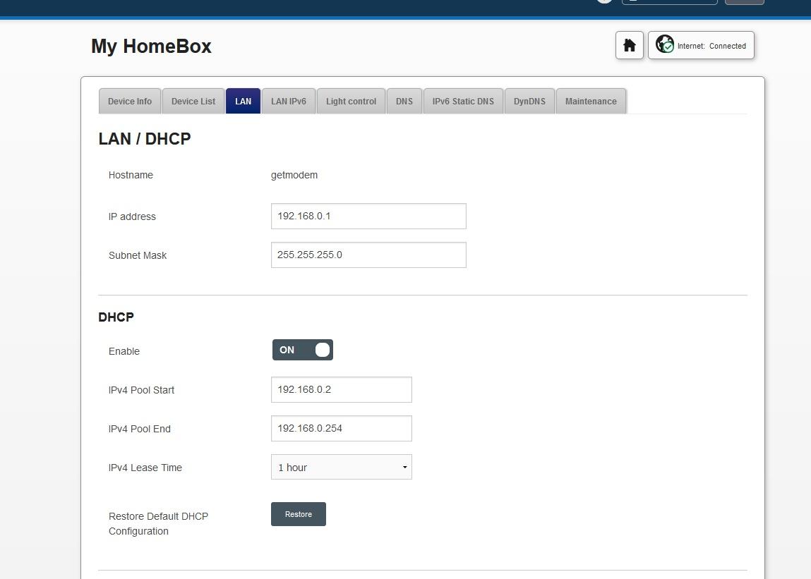

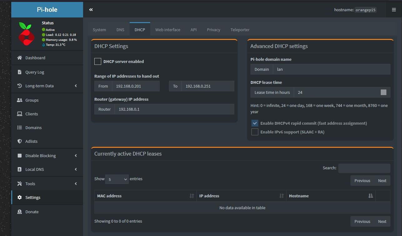

Screenshots from Router page and Pihole (ignore enable/disable):
I suspect that the PiHole device is unable to get an IP address from the DHCP :/.
Please can someone help me ![]()
