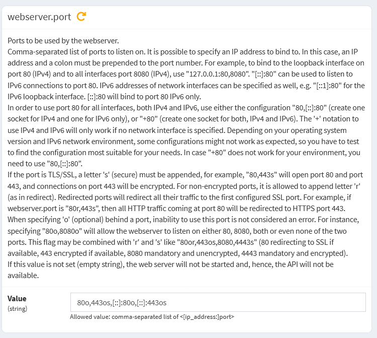

This is the default behavior and it is explained on the web interface. The same text is on the comments in pihole.toml.
If you need to bind only to a specific IP, you need to change webserver.ports accordingly.
Try to set
FTLCONF_webserver_port: '192.168.4.XXX:8080o,[::]:8080o,192.168.4.XXX:8443os,[::]:8443os'

The log above shows only IPv6 ports were used:
This is an indication that something on the host is already using ports 8080 and 8443 for IPv4.
Can you please check if there are any web servers running on the host?
Also, you should generate a Debug Log to help us finding any missing details.
Just a note:
You don't need to hide your IP because you are using a "private IP address", which means this IP is only available inside your private network.
Yeah not sure what I was achieving with hiding it but here's the log generated by the container: https://tricorder.pi-hole.net/pgvCXdEj/
I have checked for any running webservers on the ports but it doesn't seem to find anything (using sudo lsof -i), the only webserver I can see that's actually running is the included apache server.
Your debug log confirms ports 8080 and 8443 are not available:
[2025-10-21 16:00:55.541 BST 53] Initializing HTTP server on ports "192.168.4.157:8080o,[::]:8080o,192.168.4.157:8443os,[::]:8443os"
[2025-10-21 16:00:55.542 BST 53] cannot bind to 192.168.4.157:8080o: 99 (Address not available)
[2025-10-21 16:00:55.542 BST 53] cannot bind to 192.168.4.157:8443os: 99 (Address not available)

Looks like
Processes inside the container cannot bind to the IP addresses of the host because the container has no direct access to the interfaces of the host.
Did you try bridge network mode, removing the FTLCONF_webserver_port and using these ports?
