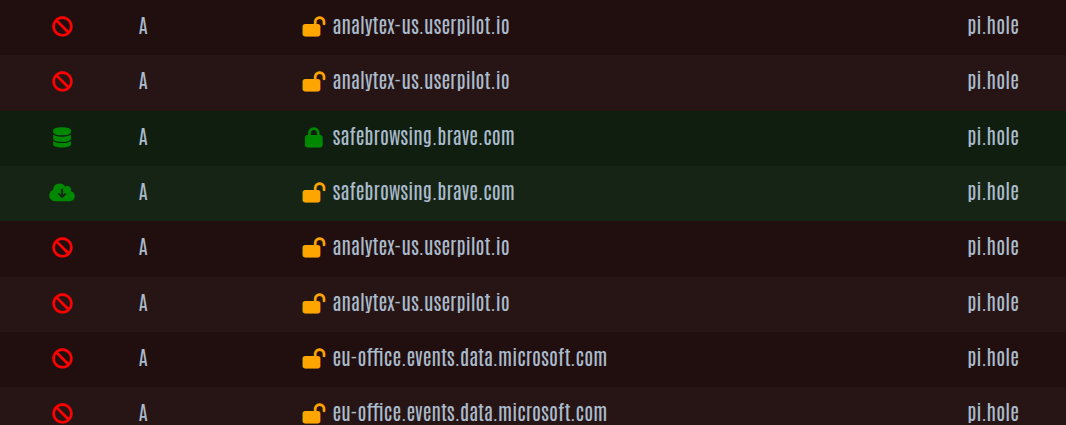

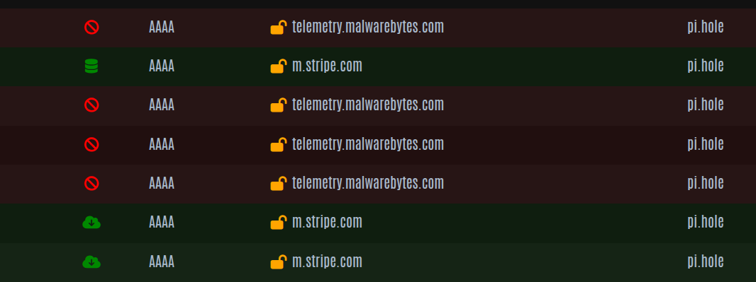

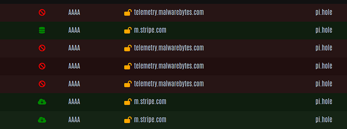

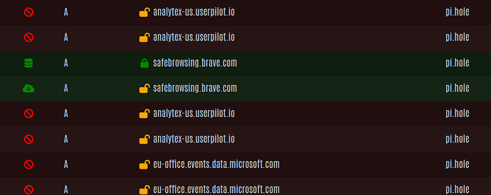

Most of them are DS replies which i think is part of dnssec but then are things like these
now i do have devices in my network for which it would make sense to send those queries but not for the pihole itself i think

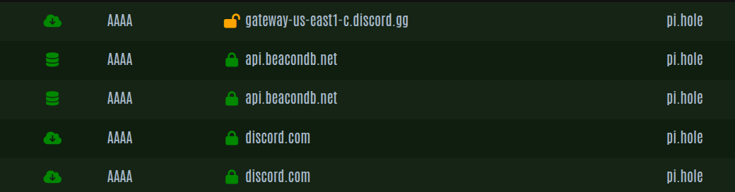

Now some of these probably are other containers on the raspberrypi i got a jellyfin instance on that running too but that doesn’t really explain the brave and discord queries
They seem to be randomly picked from queries other devices that use the pihole would make

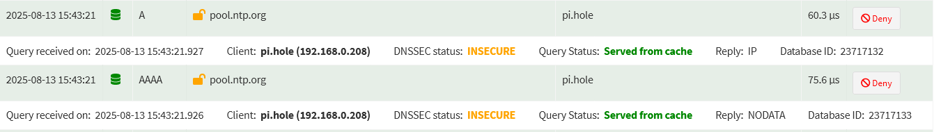

What is the IP of the client? I think it will be another container (or maybe ::).
Please click on the table row to show the details and check which IP is making the query:
In my case, queries from pi.hole are coming from another container on the same host.
maybe but the healtcheck queries of my unbound container are specifically logged as localhost (also need to change that since it makes no sense for the unbound container to query the pihole)
other possibilty is that maybe some freak race condition causes it to misslable the query?
