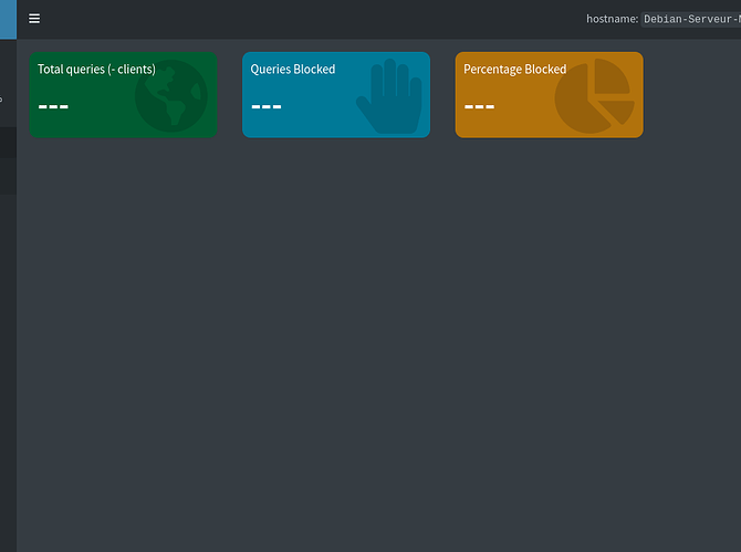

Hello everyone,
Dashboard should be filled with graphs and other datas regarding my pihole activity.
  • Debian 11
  • Pihole 5.9
  • FTL 5.14
Dasboard is complety empty.
But i precise that pihole is working well. If i go to query log, i can see all the recorded activity with the blocked request and everything.
