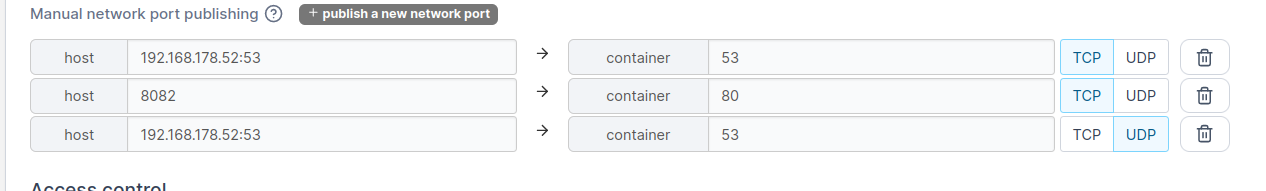

By luck i stumbled over a forums entry (unrelated to my issue) where somebody combined the port 53 directly with the host IP.
I did that as well and it works now (in bridge mode). Heureka. I just don't understand why?

  2. You don't need to publish ports using macvlan. The container will use the default ports (53, 80, 67).
  3. Also, by design macvlan doesn't allow direct communication between the host and containers, but this can be easily fixed creating a "macvlan-shim network" to allow the communication.

  1. I created the macvlan always separately and manually in Portainer, since adjusting the compose files did not always ended up as intended.
  2. Yeah, noticed that. Portainer is hiding the ports as soon you adding a container to a macvlan

Actually, Portainer just shows what docker is doing with the ports.
Ports are never changed when using macvlan.
Docker will always use the container's default ports (then Portainer sees only the default ports and shows nothing).
In Pi-hole's case, these will be the exposed ports:
