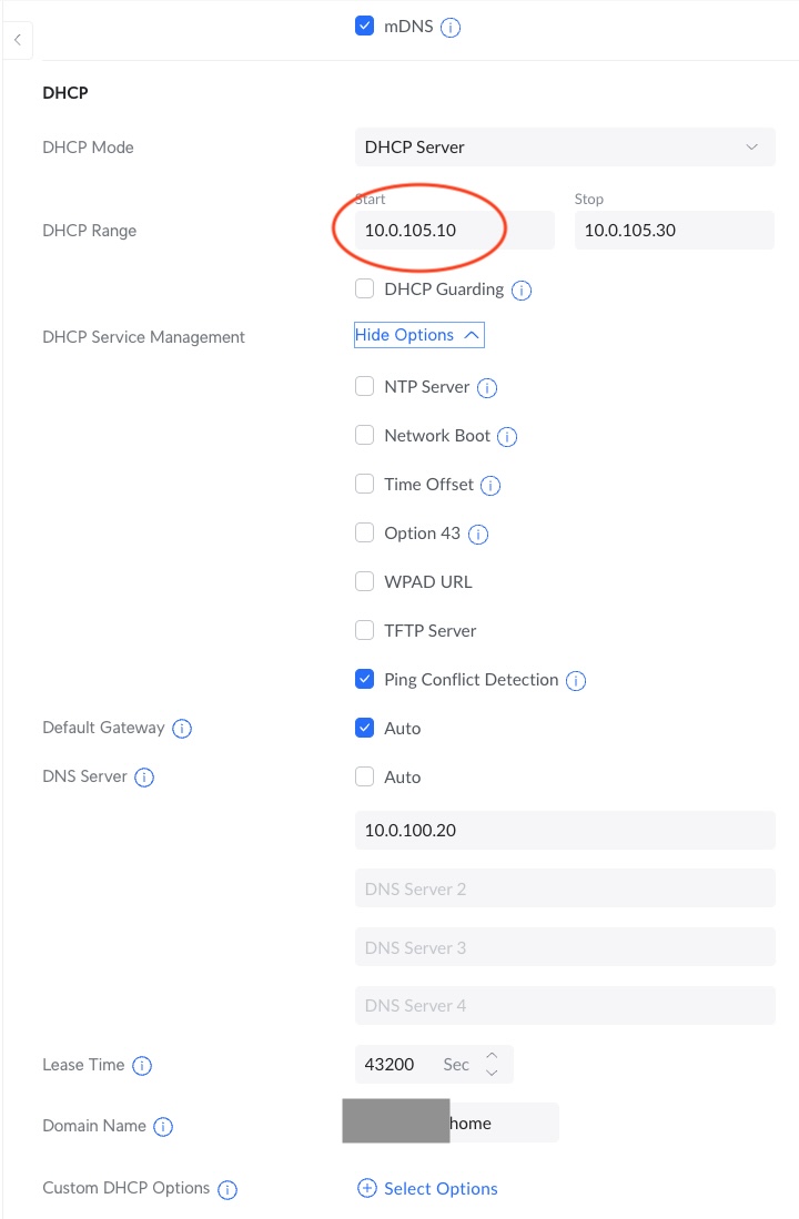

I just came to an interesting discovery!
I have four VLANs on my network:
10.0.1.0/27 (Default)
10.0.100.0/27 (MGMT)
10.0.105.0/27 (Standard)
10.0.107.0/27 (IoT)
They are pretty much configured the same way, with Standard and IoT being the ones that are configured the same way.
This issue only occurs on the Standard VLAN! See below:

You haven't disclosed that yet for the nslookups above, but assuming that they did not register with Pi-hole, that would be a strong indication that your router may forcefully redirect DNS requests from one of your subnets to a DNS resolver of its own choice.
You should check your router's firewall configuration in that regard.
@jfb and @Bucking_Horn ,
I am happy to report that I have fixed the issue.
I resolved it by disabling Content Filtering on UniFi network:
