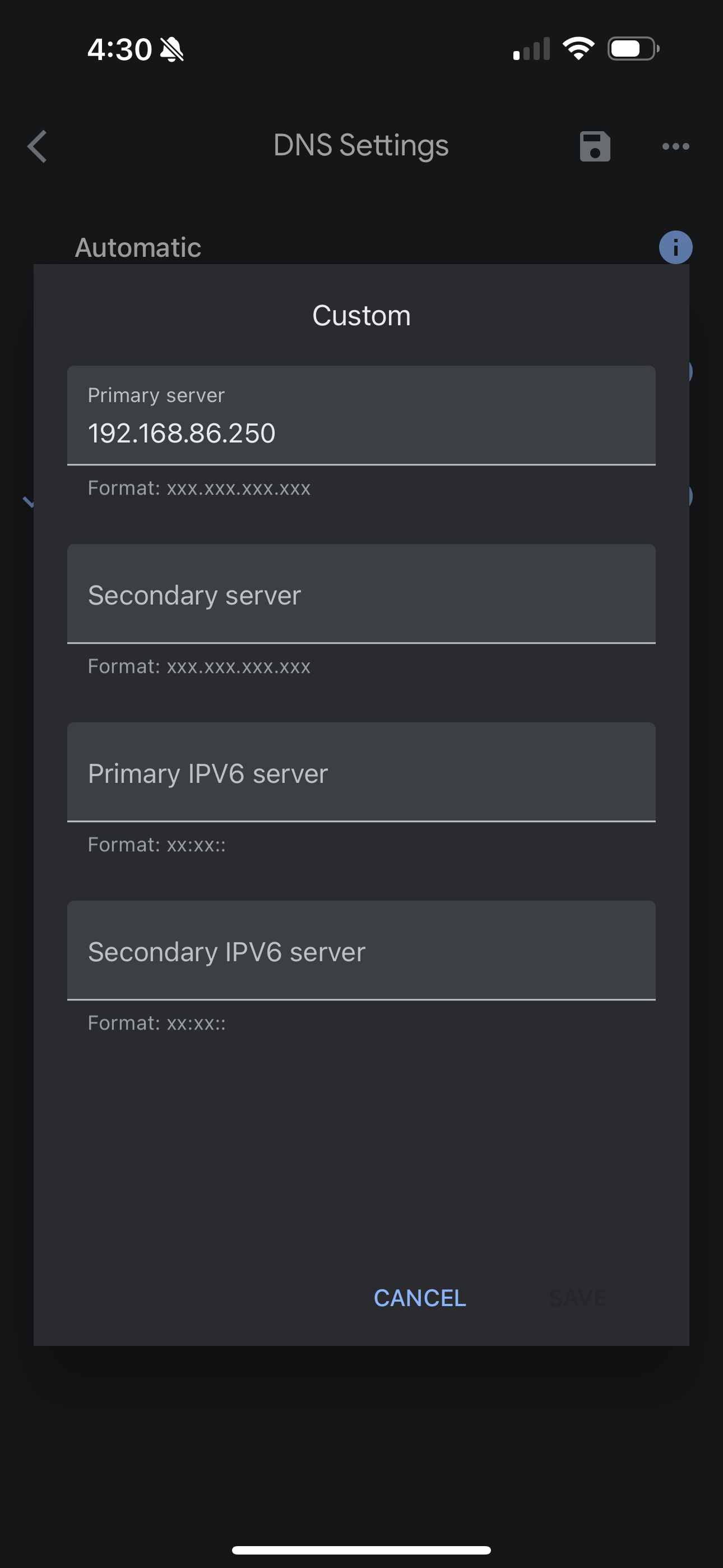

This makes a lot of sense. The group part I didn’t even realize this. Thanks. I guess the google nest router assigns itself as secondary DNS server when because this is my current configuration
Try to set Pi-hole IP in both fields.
Usually routers will show Pi-hole IP twice (that's what we want)... some routers will still add itself as a third DNS server. Let's see what happens.

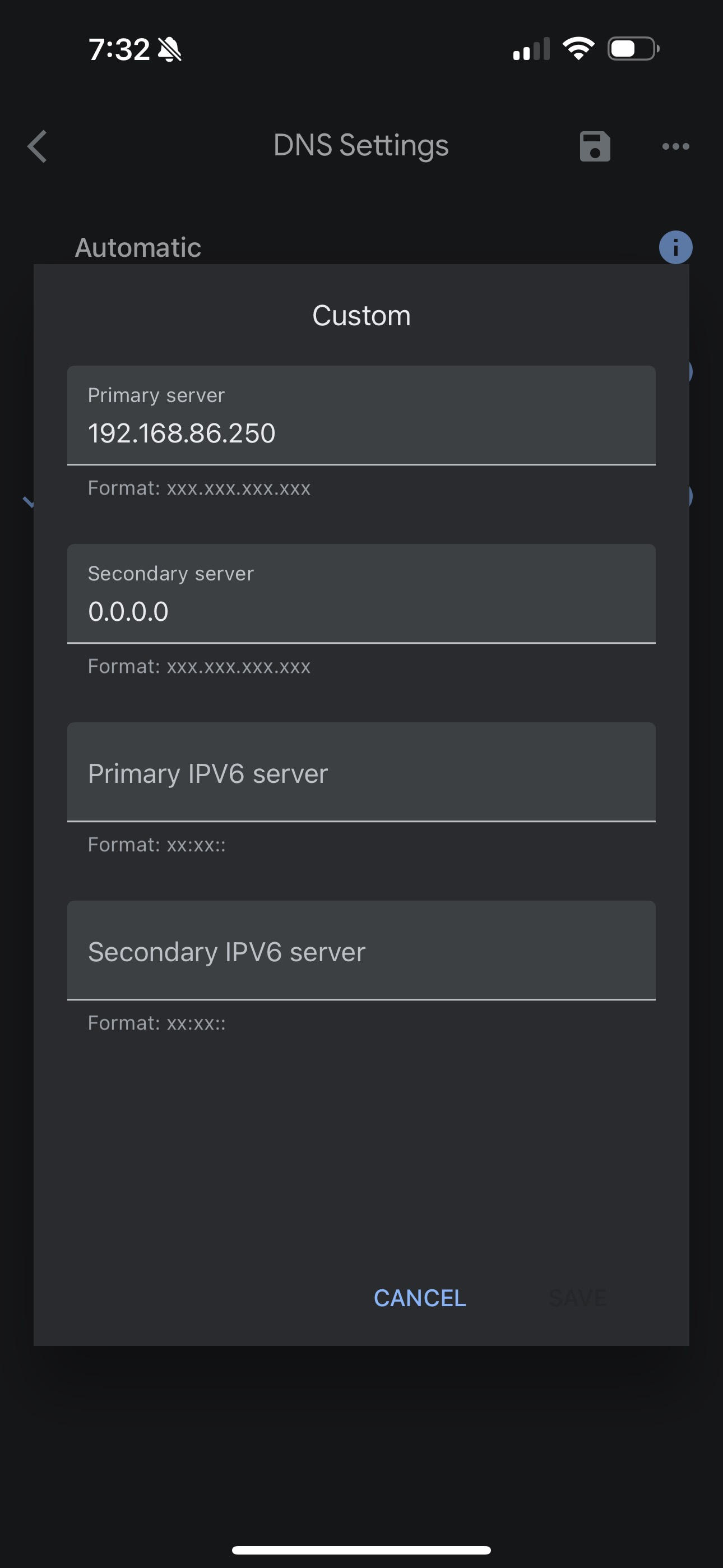

I've tried that, it won't allow dupes
Maybe you can try other IPs:
  • 0.0.0.0
  • another unused or unreachable IP (192.168.86.254, 192.168.100.1, etc.)
Your debug log, however, doesn't shows your router DHCP server giving out this Pi-hole address as a DNS server. It just gives out itself. So I'm not sure why that screenshot would show your Pi-hole as having been given out to that device. Is the screenshot from a different time to when the debug log was created when the config might have been different? I'm interpreting the word "Automatic" as showing that this address was obtained automatically, but perhaps the interface isn't clear from the screenshot and this address was entered manually?
Screenshot of router setting is what it has been since I setup my pihole.

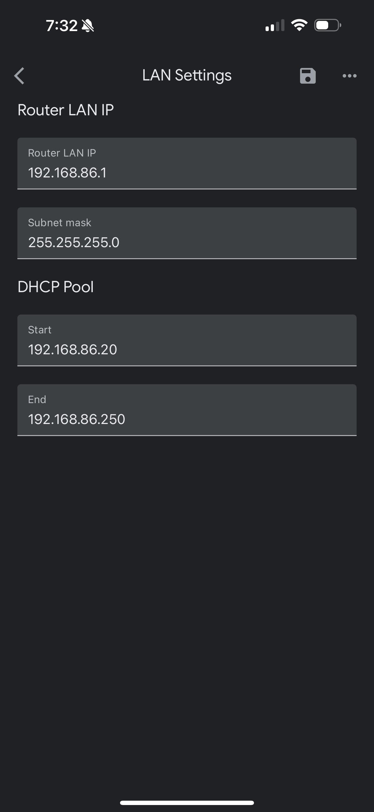

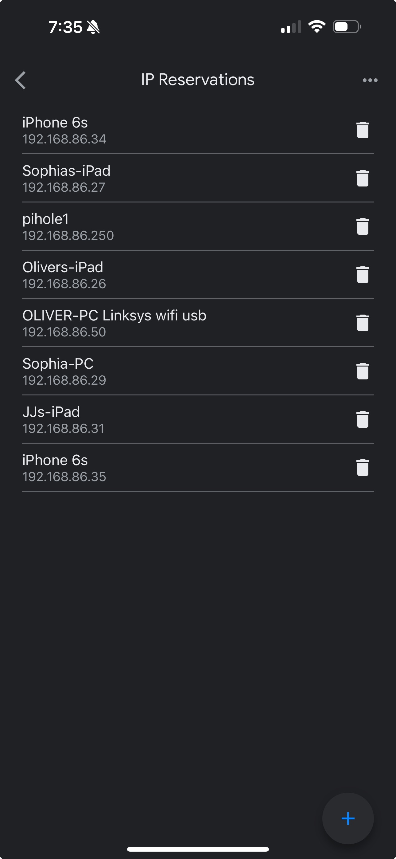

Attaching more screenshots of my router settings, google really doesn't make this easy. There is a LAN setting, and my new DNS settings with 0.0.0.0 as secondary DNS, also a screenshot of DHCP IP reservations on the router
Should I be using piholes DHCP reservation table as opposed to the nest router?

So I have setup my google router to only hand out one IP and that is for the pi hole. Pi hole is now enabled for DHCP. DHCP ip range does not overlap with pi hole. Blocked domains are still not blocked.
Here is a new debug token
https://tricorder.pi-hole.net/UnTaJSWp/
That should work, as long as you have restricted your router's DHCP range to just that one IP, and that IP is not in your Pi-hole's DHCP range.
