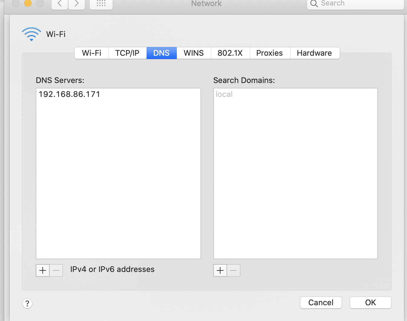

No ads are blocked on MBP. For example, I have facebook blocked on my network. It is not accessible all other devices but it works when accessed on MBP. Also, the ads on other sites keep showing up.
I use firefox and have verified that network settings of Firefox do not override DNS. So, all traffic goes through pihole but not blocked.

From the terminal on the MacBook (and not via ssh or Putty to the Pi), what is the output of
nslookup pi.hole
Hi @jfb, Thank you for response. Please find below the output of that -
nslookup pi.hole
Server:		192.168.86.171
Address:	192.168.86.171#53

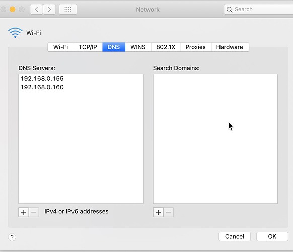

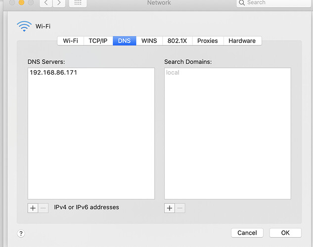

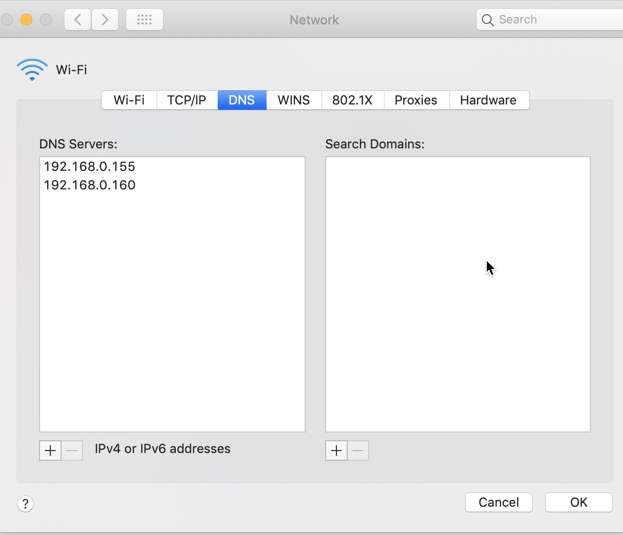

On the MBP, what DNS settings are shown in System Preference > Network > Advanced > DNS. In this example, DNS assignments lead to two Pi-holes.
And, let's flush the DNS cache on the Mac just because we can. From the MBP terminal run:
dscacheutil -flushcache
There i tried without explicit DNS server and now I have pi IP there. I had tried DNS flush earlier too and did it again now but still no change.
