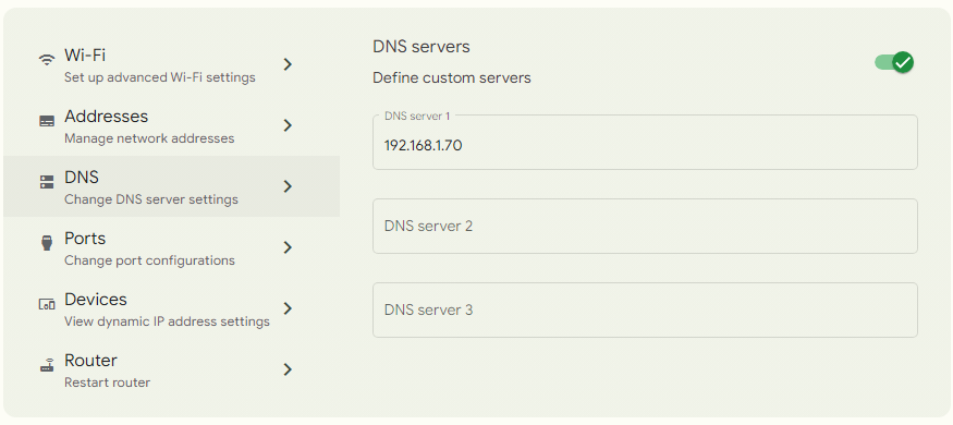

Where did you try to set the IP?
On the DHCP (sometimes is called LAN or local network) section? Or on the WAN / Internet section?
You should try to set Pi-hole as DNS server on the DHCP/LAN section.
After that you'll need to force the devices to renew DHCP leases, so they can use the new settings.
I tried messing around with the addresses section as well to no avail.
Here's the most current debug log.
https://tricorder.pi-hole.net/xSvnuwpJ/
While the setting page looks promising, it doesn't say if the DNS setting apply to the router itself (WAN) or the DHCP (LAN).
There seems to be no specific setting for DNS under the LAN tab.
In you last debug log, your router still advertises only itself as DNS server.

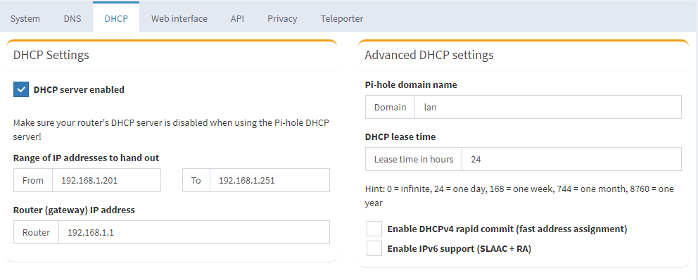

You could try to disable the routers DHCP server and activate Pi-holes DHCP server. If you can't disable it, limit the DHCP as much as possible and use a non-overlapping pool on Pi-hole.
Would that look something like this? I had tried this setup in the past with no luck. The debug log still shows the router as the DNS.
(I tried it both with the routers DNS option turned off and on)
https://tricorder.pi-hole.net/P8zcqMhe/
The debug now shows rightfully 2 DHCP servers on your network. One of them (Pi-hole) advertises itself as DNS server.

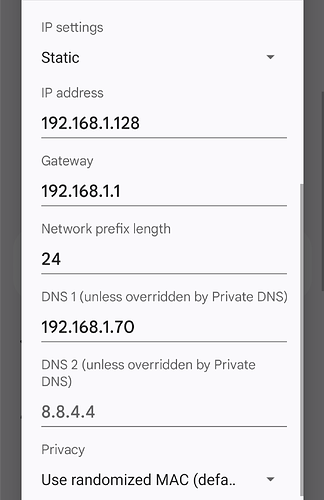

Here are my phone settings just to make sure I'm doing those right.
Don't insert another DNS server next to Pi-hole. Why don't you use IP assignment via DHCP? Did you turn off Private DNS?
Please forgive me if I misinterpret anything as I have a basic understanding of these settings.
insert another DNS
If that's referring to the 8.8.4.4 address, that's actually blank. There's no address there.

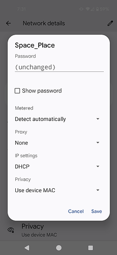

I thought I had to manually point my phone to the Pi-hole using the static setting? I've tried using the DHCP setting on my phone and get the same result.

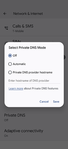

I turned it off yesterday as a potential solution and have kept it off since.

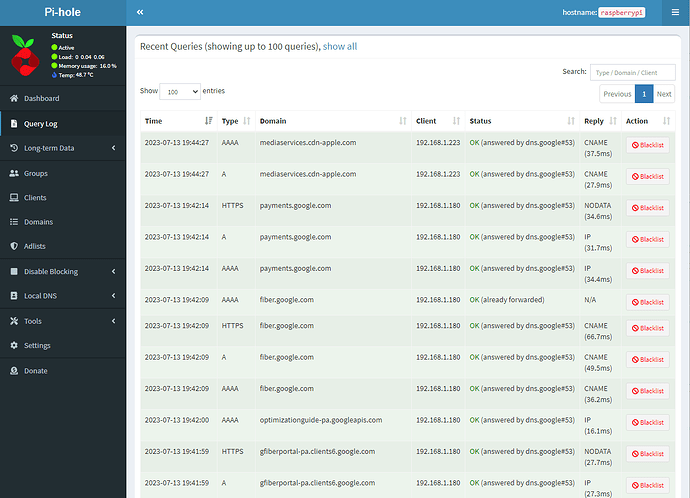

This is the query log after browsing for a while on my phone and desktop.
https://tricorder.pi-hole.net/dHFOMvsq/
I'm not sure why it's not working. It looks like your RokuLivingRoom is using Pi-hole as DNS server and a device with IP ending in .180 (which interestingly is outside of your DHCP scope) as well.
