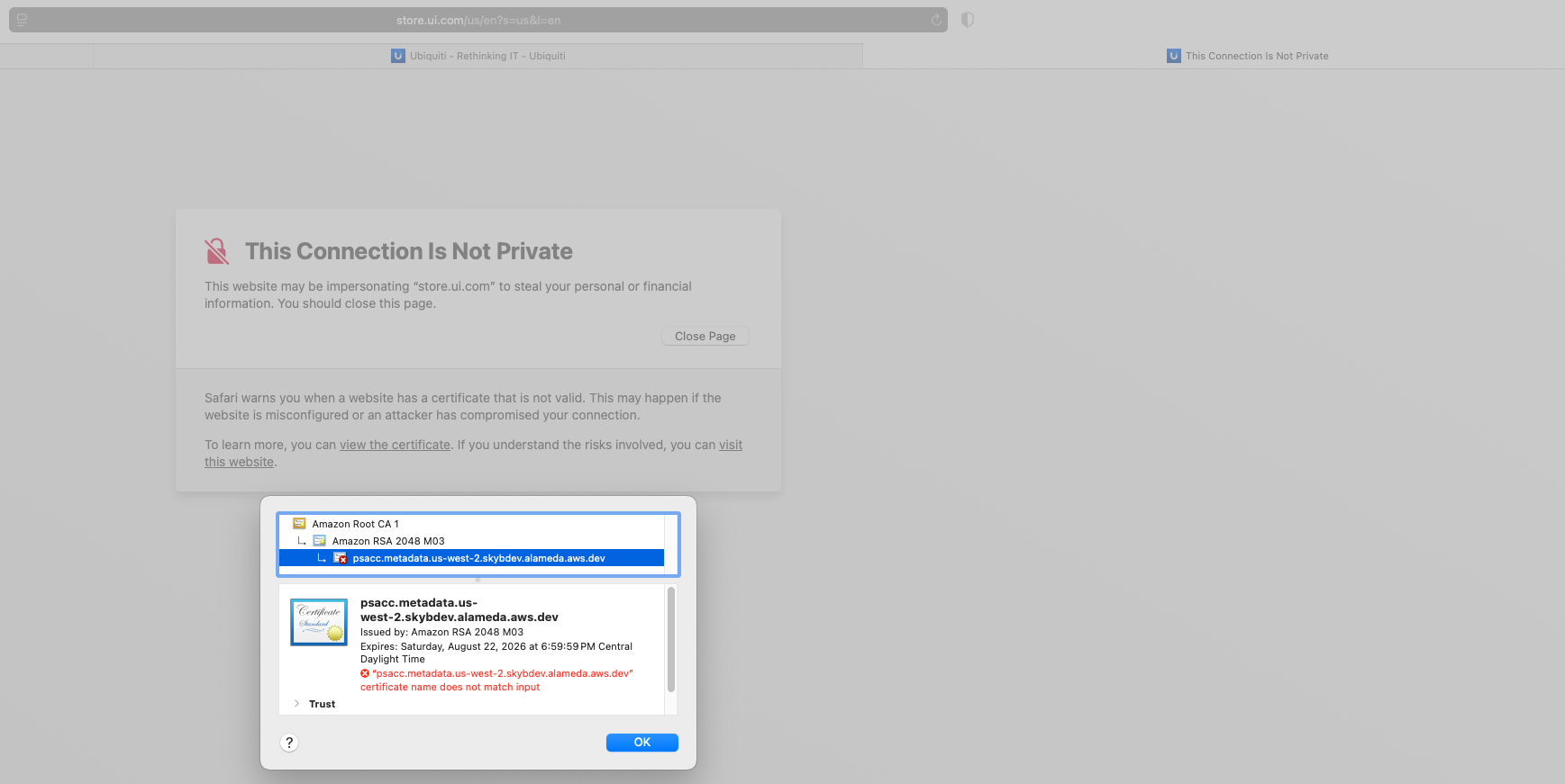

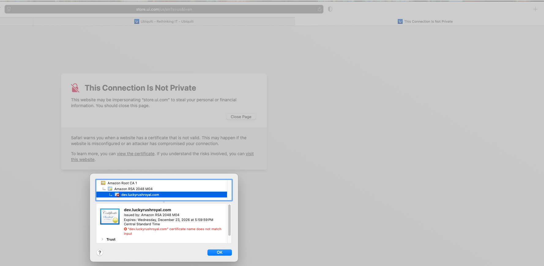

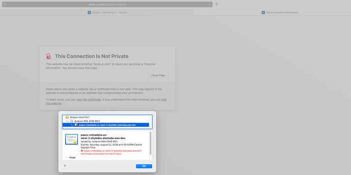

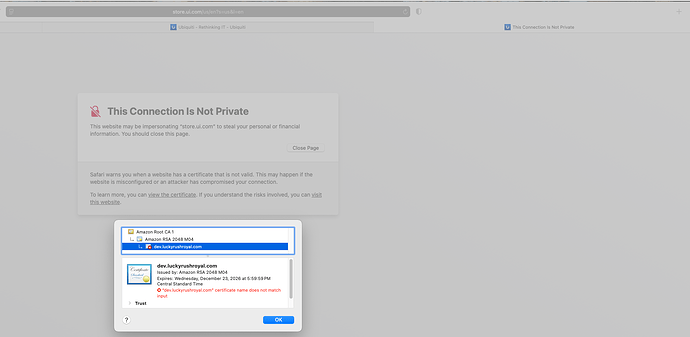

What I’m seeing:
Pihole with unbound (DNS) will serve invalid certificates for sites. I can refresh and get a different invalid certificate. If I switch to a vpn, I get the correct certificate. From then on the site will work if I switch back to pihole.
See images of an example when trying store.ui.com

The version of the site you receive could be geofenced or otherwise IP limited and you don't see the same content via the VPN.
If it's limited to one site then given that the certificates you are getting are for the dev site of some dodgy looking game app I'd be concerned with some sort of ad hijacking on that domain.
If it's other sites too then probably more concerning.
(I'm unable to reproduce this personally, the store.ui.com website seems to be working just fine with unbound).
It’s random. Sometimes happens with other sites, but isn’t like it is all of them or none. It’s not always the same site. I haven’t figured out a pattern.
The weird part is that I can refresh the page and I will still get the invalid certificate. If I close browser, it doesn’t make a difference. If I connect to vpn, and the go to the site, it works fine with the certificate. From that point on, the site will function correctly. It “feels” like some type of caching issue.
