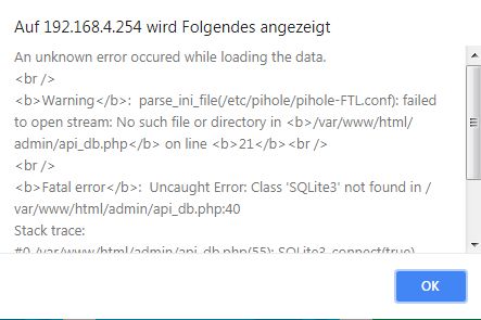

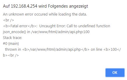

After login, when hitting anything I get the following popup:piholestuck2
See this :
following your link,
php --ini gives me
pi@raspberrypi:~ $ php --ini
Configuration File (php.ini) Path: /etc/php/7.0/cli
Loaded Configuration File: /etc/php/7.0/cli/php.ini
Scan for additional .ini files in: /etc/php/7.0/cli/conf.d
Additional .ini files parsed: /etc/php/7.0/cli/conf.d/10-opcache.ini,
/etc/php/7.0/cli/conf.d/10-pdo.ini,
/etc/php/7.0/cli/conf.d/20-calendar.ini,
/etc/php/7.0/cli/conf.d/20-ctype.ini,
/etc/php/7.0/cli/conf.d/20-exif.ini,
/etc/php/7.0/cli/conf.d/20-fileinfo.ini,
/etc/php/7.0/cli/conf.d/20-ftp.ini,
/etc/php/7.0/cli/conf.d/20-gettext.ini,
/etc/php/7.0/cli/conf.d/20-iconv.ini,
/etc/php/7.0/cli/conf.d/20-json.ini,
/etc/php/7.0/cli/conf.d/20-pdo_sqlite.ini,
/etc/php/7.0/cli/conf.d/20-phar.ini,
/etc/php/7.0/cli/conf.d/20-posix.ini,
/etc/php/7.0/cli/conf.d/20-readline.ini,
/etc/php/7.0/cli/conf.d/20-shmop.ini,
/etc/php/7.0/cli/conf.d/20-sockets.ini,
/etc/php/7.0/cli/conf.d/20-sqlite3.ini,
/etc/php/7.0/cli/conf.d/20-sysvmsg.ini,
/etc/php/7.0/cli/conf.d/20-sysvsem.ini,
/etc/php/7.0/cli/conf.d/20-sysvshm.ini,
/etc/php/7.0/cli/conf.d/20-tokenizer.ini
Check /etc/php/7.0/cli/conf.d/20-json.ini to see if you can enable the JSON module.
The file is there but emmpty
Have you installed the PHP JSON package?
shouldnt it be installed together with php?
Overall, shouldnt it installed with pihole alltogether?
Correct. It should have been installed with php.
run this to have it installed: sudo apt install php-json
no effect, sorry
pi@raspberrypi:~ $ sudo apt-get install php-json
Reading package lists... Done
Building dependency tree
php-json is already the newest version (1:7.0+49).
0 upgraded, 0 newly installed, 0 to remove and 0 not upgraded.
add the following strings to the 20-json.ini
; configuration for php json module
; priority=20
extension=json.so
after, restart lighttpd sudo systemctl reload-or-restart lighttpd.service
seems that did it!

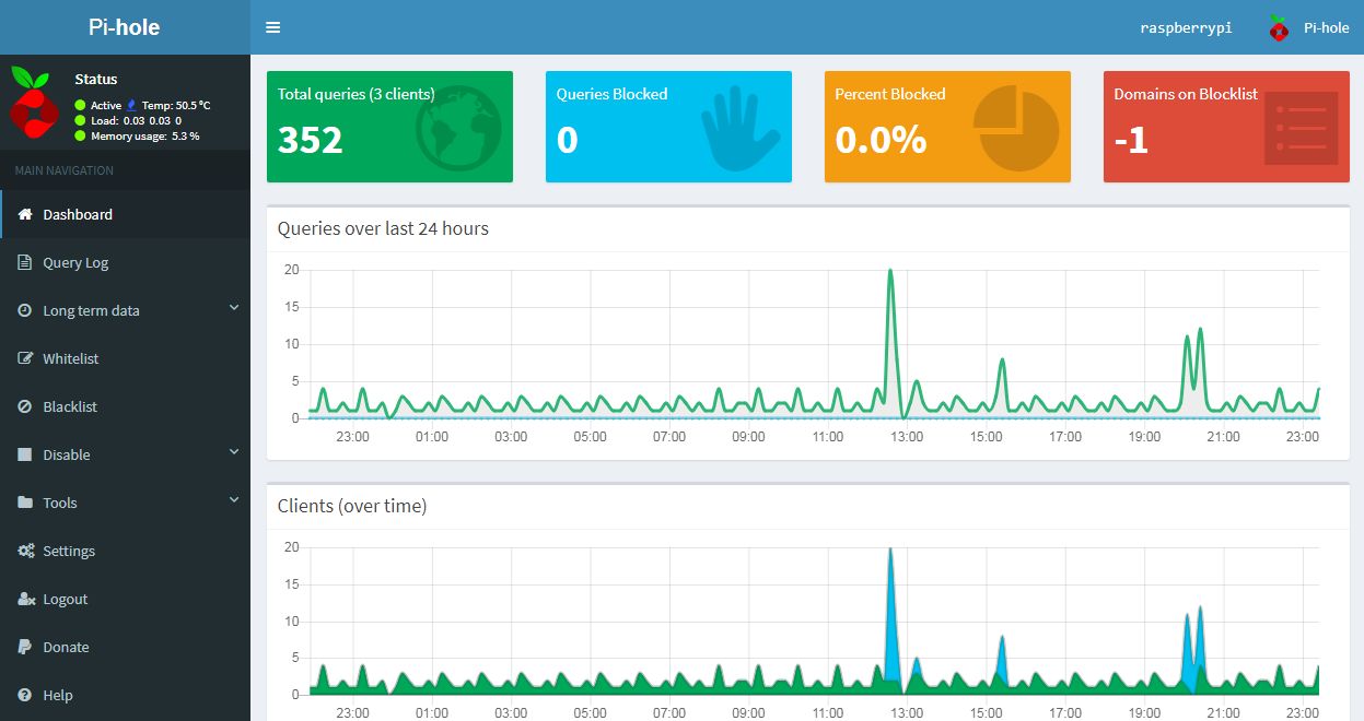

edit: No, sorry, there seem to be more.
Blocklist seems empty, refresh via tools -> update leist works, gives no errors, but frontend still shows -1

After fixing the first errors I was able to generate a token:
7stl1giy6z
run sudo apt update && sudo apt upgrade -y, clear cache and cookies and re-try.
The reason for the -1 is that you are missing some necessary files:
   [2018-05-21 00:00:02.132] Error: failed to read /etc/pihole/list.preEventHorizon
   [2018-05-21 00:00:02.132] Gravity list entries: -1
Share the output of pihole -g and then make a new debug token.
