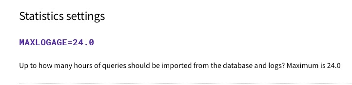

Per the documentation for FTLDNS configuration (Configuration - Pi-hole documentation), the maximum value is 24 hours.
From v4.2.3 on, we simplified the code in a number of places to remove some of the most complex code structures. It turned out that they were a major player in the instability some users have seen with the v4.2 release.
Unfortunately, this simplification results in having to hard-code the maximum value for MAXLOGAGE and we chose 24 for obvious reasons. If you want to change it back to 96 hours, that should be possible but you'll have to compile pihole-FTL locally yourself (with a changed compile-time value). We can assist you with what you'd need to change and how to compile locally if you are interested.

The info related to MAXLOGAGE I found on different places in the internet were inconsistent: some cite a maximum of 31 days or 744 hours, some others 24 hours.
Based on the reply of DL6ER I assume 31 days / 744 hours is valid for versions before v4.2.3, 24 hours valid for v4.2.3 and later.
