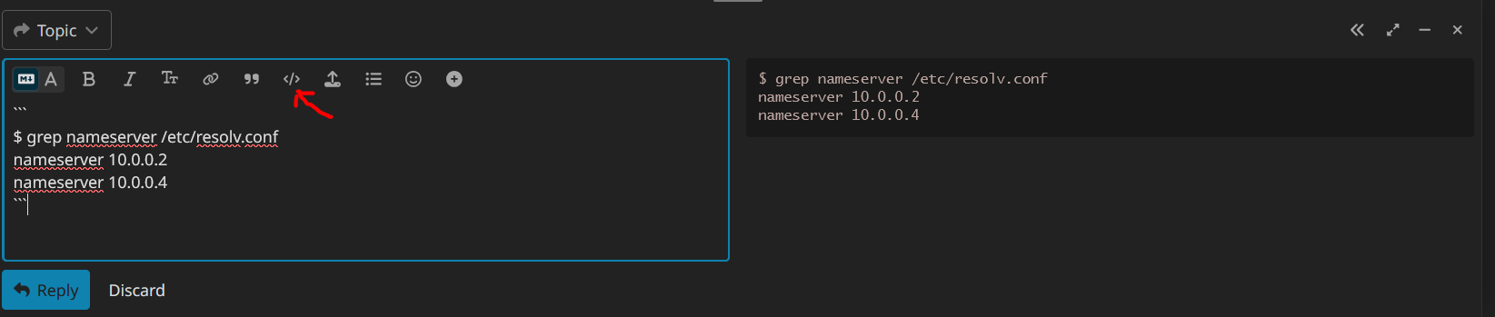

Use the </> format button on the code output before posting here pls?
Eg:
EDIT: Oh if any IPv6 addresses are displayed in the output, redact the latter part!
Eg: 2600:XXXX
