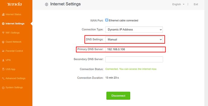

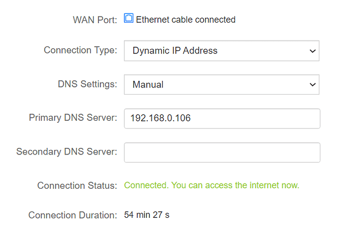

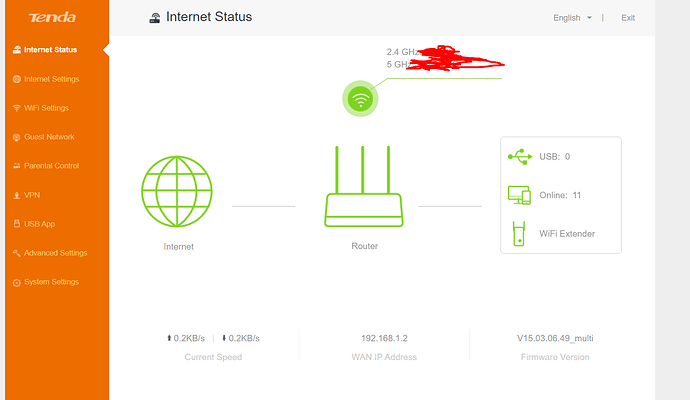

What does it show in Status/System Information on the router? What happens when you set the DNS manually on the Windows device?
Router status:

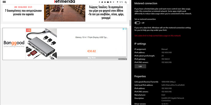

When setting manually the DNS the ads keep popping up:
Quite the mystery, especially with the manual setting. Hope a developer can diagnose something in the debug log. Good luck.
