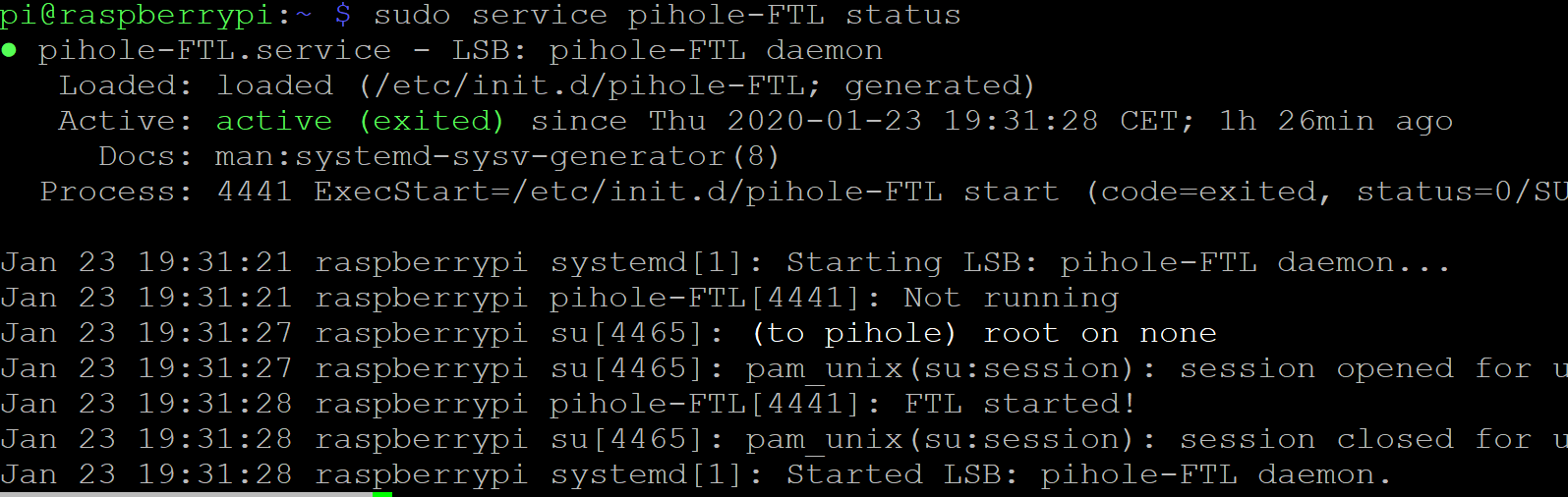

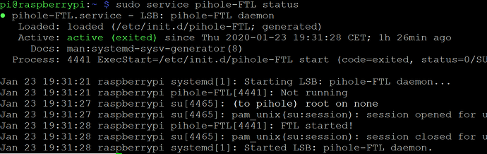

I also noticed pihole_FTL did not start fast enough, according to pihole -g, a retry counter (120 seconds) ran on my screen. This appears to be a little excessive, I checked the status in another putty session, pihole-FTL was up and running long before the timer expired. Multiple short (30 seconds) retry test loops?
That's the max time to wait, the check is once per second.
I don't want to argue here, but I specifically noticed, using sudo service pihole-FTL status, pihole-FTL was reporting a proper (green) state after less than 60 seconds, however the counter ran to 0.
According to the code (if I'm smart enough to understand it - NOT), this would mean DNS resolution was unavailable for 120 seconds. Correct?
Green status where? On the service output?
That just says the daemon is up and running. Doesn't measure anything about being able to resolve.
getent hosts "${lookupDomain}" which translates to getent hosts pi.hole is the test. The timer will continue until that condition is true or it reaches 0 and the assumption is that things are broken beyond our capability to repair.
Ah, if there is no locallist file then "raw.githubusercontent.com" is used. Are you blocking that?
It doesn't have access to the data in between the time 3 starts and 5 ends (where 3-4 is basically not measurable and only 5 counts here). sqlite3 blocks the entire access to the database during this time.
