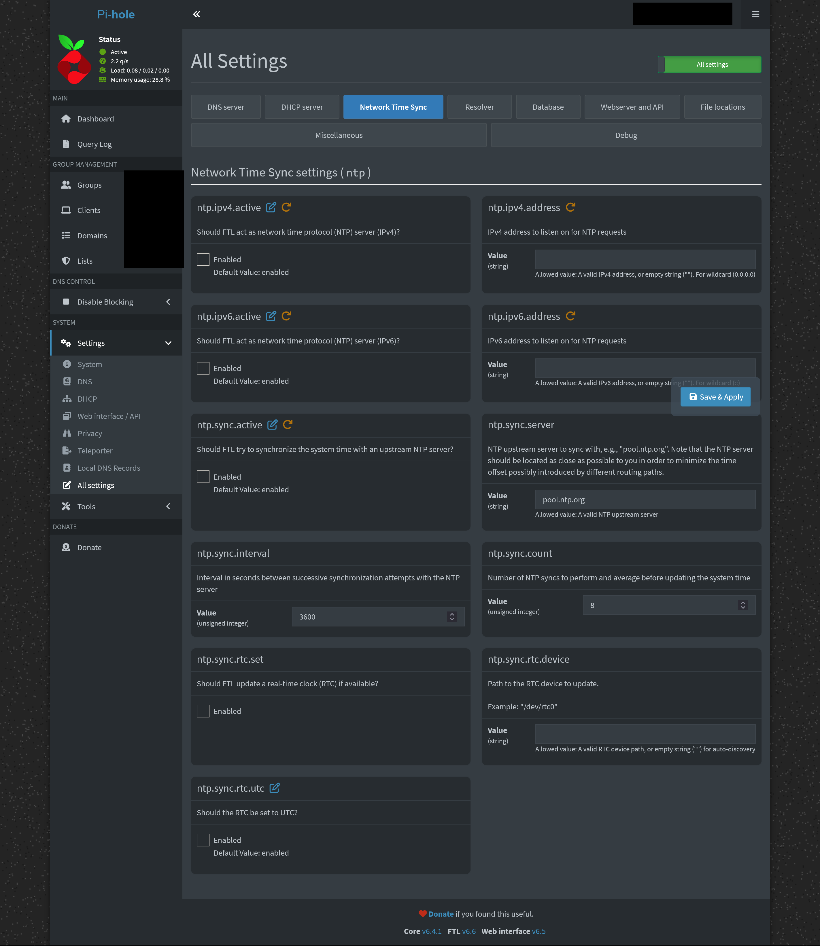

Without changing any pihole settings, the web-interface right now shows the following:
Local (RPi):
OCI (Cloud):
So basically, the nanosleep measurement that I pasted earlier was with both NTP syncs disabled.

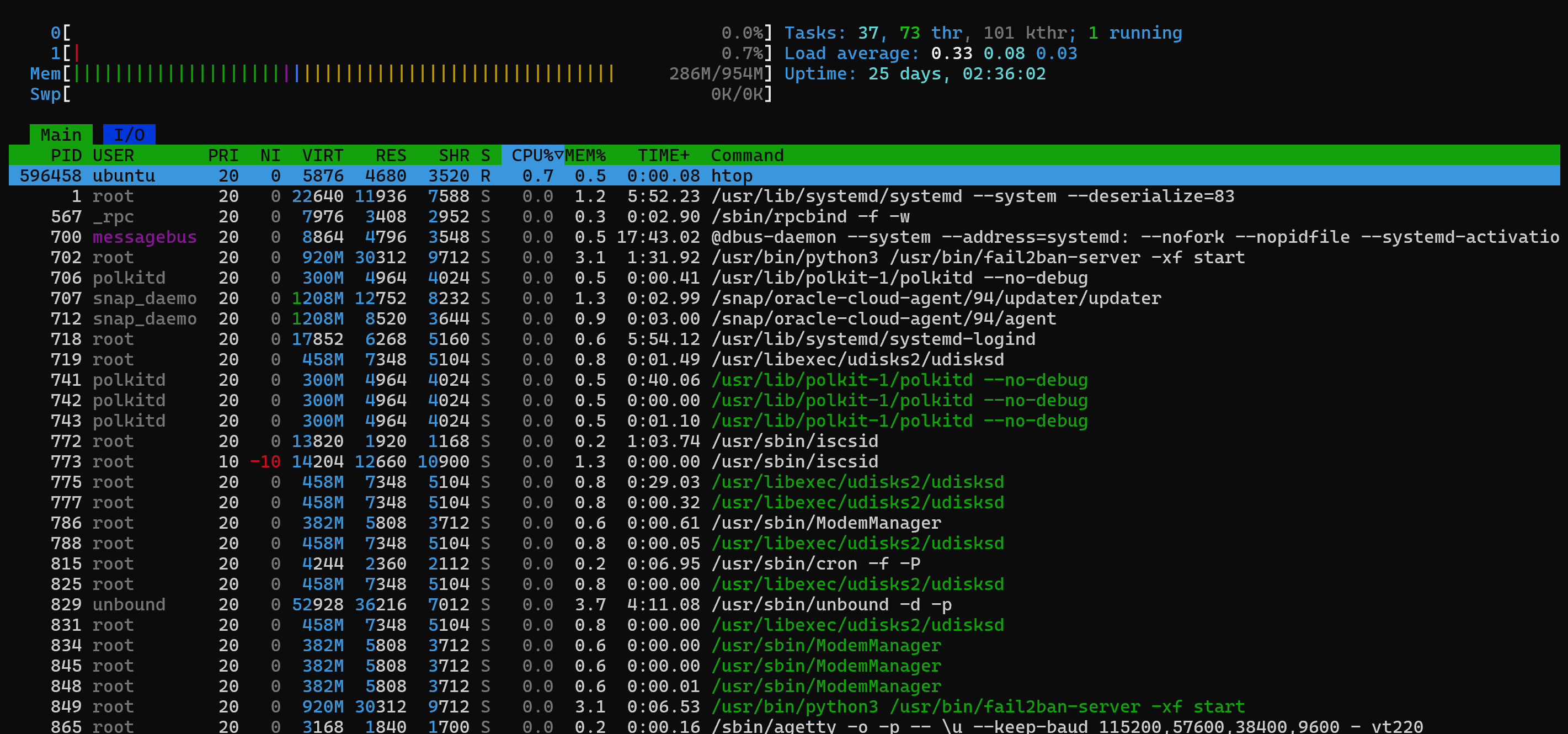

Yes, that’s what happened when I pasted the htop output above
I have disabled ALL public access to the server (using OCI’s ingress and nft firewall rules) (amongst other config changes)
Now the web admin is only accessible over the VPN.
I’ll continue to monitor. The current system stats:
Ps. I pasted Top output earlier and not htop. Mea culpa

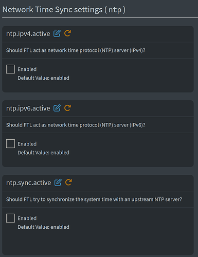

Then how come those --config ntp.{ipv4|ipv6|ntp}].active all returned true?
Did you toggle them true and false just before creating your debug log?
And what do they return now?
I have no idea why the settings conflict, but I haven’t toggled or changed ANY NTP setting, especially before or after creating the debug log tokens for this thread.

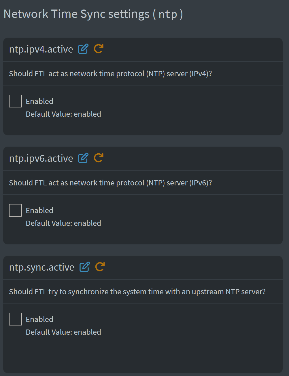

I ran those commands again just now:
ubuntu@pihole-vpn:~$ pihole-FTL --config ntp.ipv4.active
true
ubuntu@pihole-vpn:~$ pihole-FTL --config ntp.ipv6.active
true
ubuntu@pihole-vpn:~$ pihole-FTL --config ntp.sync.active
true
I don’t know how to explain this.
I’ve taken a screenshot of the whole NTP settings page in my pihole admin interface. None of the settings is modified for the screenshot.
Updated debug token:
[✓] Your debug token is: https://tricorder.pi-hole.net/fSHAKTPh/

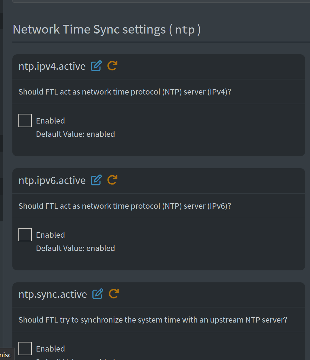

It shows false with sudo
This looks like a bug in pihole-FTL.
I can recreate that observation on an RPi Zero 2 running RPi OS Trixie/13.
While puzzling, this would seem like a display issue - internally, your pihole-FTL is using the values as configured.
I don't think it would be related to your random DNS resolution failures.

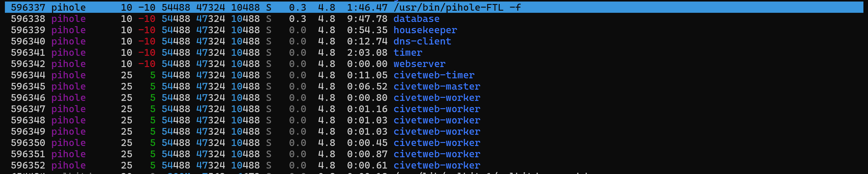

The highlighted row is the pid of Pihole-FTL. I enabled the “show custom thread names” option in htop before I took the screenshot above.
