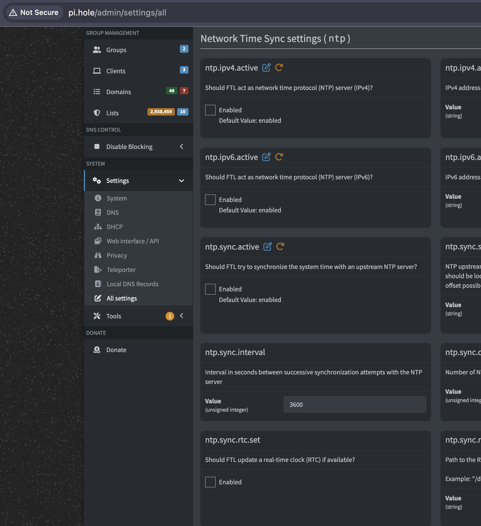

Same here:
> pihole-FTL --config ntp.ipv4.active
true
> pihole-FTL --config ntp.ipv6.active
true
> pihole-FTL --config ntp.sync.active
true
Log https://tricorder.pi-hole.net/hjxya6k8/

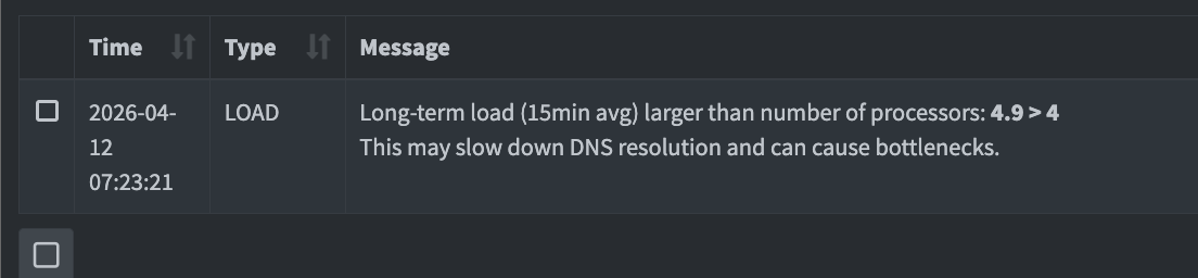

Heres a bit of a dump from the logs:
> sudo zgrep -B 50 "Segmentation fault" /var/log/pihole/FTL.log*
/var/log/pihole/FTL.log-2026-04-12 03:38:18.076 IDT [158324/T158328] INFO: Gravity database has been updated, reloading now
/var/log/pihole/FTL.log-2026-04-12 03:38:18.409 IDT [158324/T158328] INFO: Compiled 24 allow and 3 deny regex for 37 clients in 314.5 msec
/var/log/pihole/FTL.log-2026-04-12 07:18:21.614 IDT [158324/T158329] WARNING: Long-term load (15min avg) larger than number of processors: 4.2 > 4
/var/log/pihole/FTL.log-2026-04-12 07:23:21.622 IDT [158324/T158329] WARNING: Long-term load (15min avg) larger than number of processors: 4.9 > 4

Gemini was telling me that the crash its likely due to low powered hardware and a large blocklist? Is there anything to that or just typical AI nonsense?
I am now using forceDisk=true as I tried to reduce HW load as an early troubleshooting step (Even though it ran fine in earlier versions without this so IDK if even necessary)
I don't think performance is an issue for your system, even with a blocklist ~3M strong:
Your Atom N2600 would perform similar to an RPi Zero 2, but with an ample 2G RAM - 4x more than the Zero. One of my own Pi-holes runs on a NanoPi Neo with 256M and ~900K blocklist entries without a quirk.
The civetworker thread is related to Pi-hole's web server, so it would seem unlikely that a large blocked domain count would affect it.
But let's wait for DL6ER's insights.
Do we have some kind of table somewhere which shows the limits or certain hardware combined with a certain amount of blocklist entries ?
Touch wood but since I edited my host nameserver to external public DNS, I havent had an FTL crash
