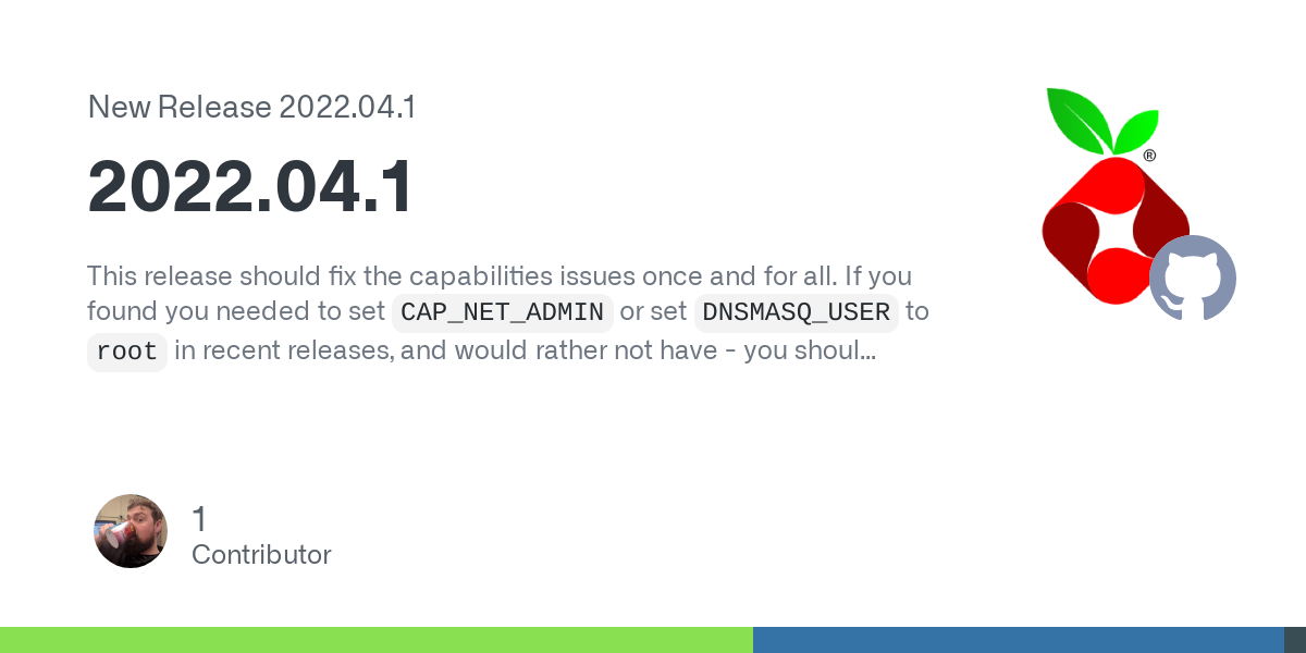

Ah, ok. I just saw the info about the new release. Will try it later today...
The new image is not working for me (without NET_ADMIN)
docker run ... -e DNSMASQ_USER=root --label=com.centurylinklabs.watchtower.monitor-only=true pihole:pihole:2022.04.1
Seems to work for me also. Thanks for the quick reaction, guys! :slight_smile:
:confounded_face:
Can I ask what hardware you are running on? Also what does your run command/compose file look like?
A post was split to a new topic: New docker version does not solve pihole flush
Wah!
Set the DNSMASQ_USER to pihole, instead of pinhole (damn you, autocorrect on MacOS!) works.
Thank you and cheers
hahaha, excellent news. Just FYI DNSMASQ_USER defaults to pihole, so you can safely remove that env var if you like

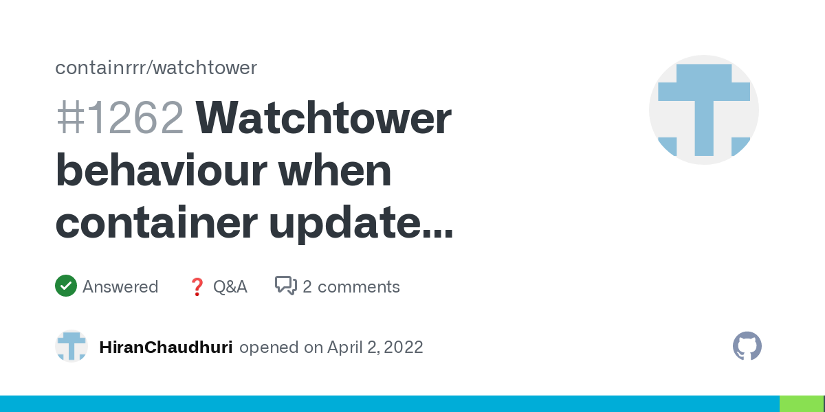

With that I have it running again. My point why this problem is not solved enirely is now: When/how would I go for updates? Which updated version to pick? Since pihole development needs to continue and push changes this problem can likely not be solved in the pihole project.
I believe the problem could be resolved by improving Watchtower. A lot of users should be able to enjoy the benefit then. Hence I raised
I cannot emphasise this enough:
If a Pi-hole release would make changes to data structures that are meant to survive container restarts, and your Docker Pi-hole has been configured accordingly, it may not be possible to return to a last known good configuration by simply using the previous image in case of a failed update.
If you intend to automate this, you'd have to think about and put in place an automated backup and restore strategy for those data as well.
