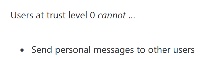

I don't have that - perhaps because I'm a new user?
Ah probably, the forum tutorial (discobot, see your messages) can take you through a tutorial on the forum features, after which you start getting features granted.
I guess I'm at this trust level...

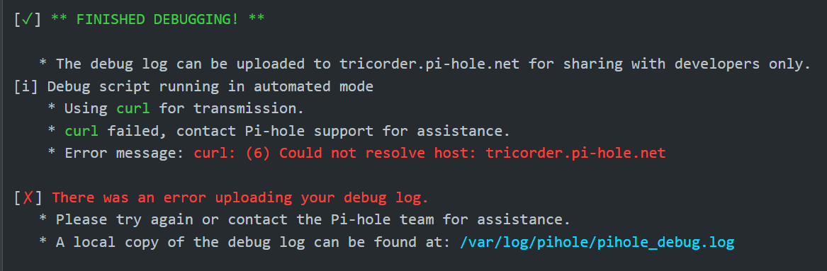

I recommend you deleting this and generating a new log.
When you create a log, it ask you if you want it to be uploaded to tricoder or not. It defaults to No, but you can write "y" and press enter for it to upload it.
When doing so, you upload your logs to a webpage that only pihole's team members can access and then share the link here.
I can't upload. That's the problem. It was working fine last year, it was working fine when I used the computer at the weekend - it wasn't working this morning. I can sometimes use this main machine that is linked to the router via ethernet.

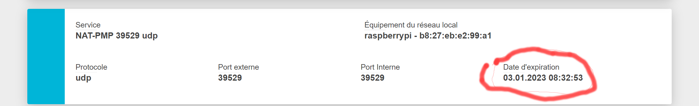

I think I found the problem.
Just got to find out how to make the expiry in the distant future... (Just wish I knew where I'd found this because it has now disappeared). I also have this:

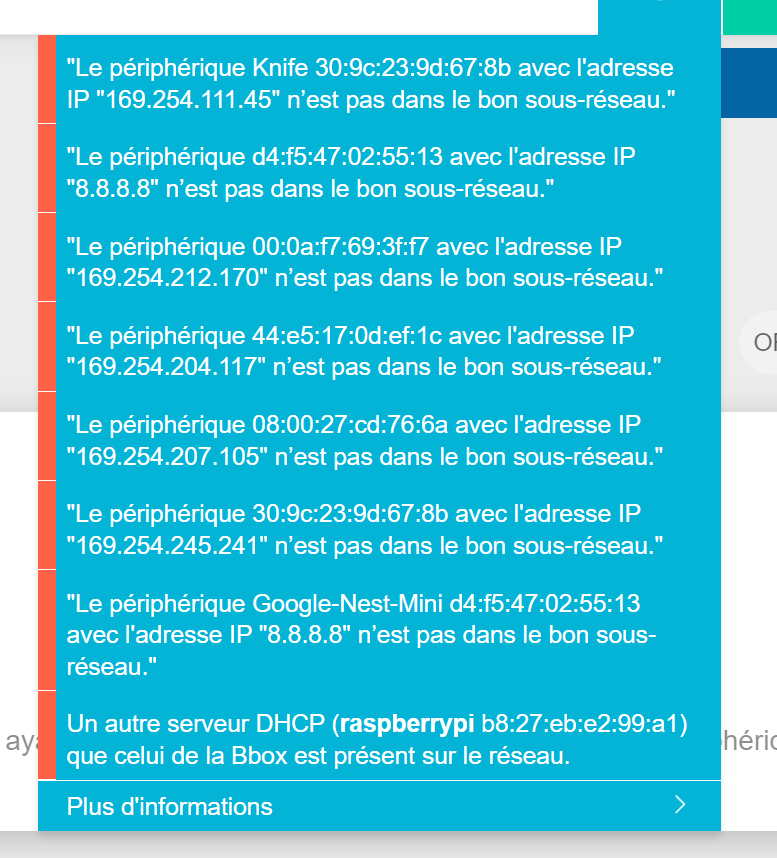

B
I was using the rpi as a DHCP server and I've turned the router's DHCP back on to be able to access this page, but none of the other computers on the network have internet access. The mobile phones are fine because they can use data, but the wifi computers can't.
