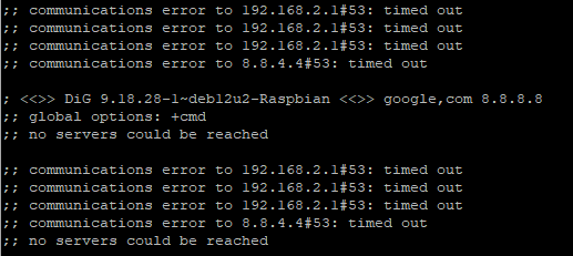

So I tried dig google.com 8.8.8.8 and got
I'm thinking that perhaps my router is blocking either the send or return of the forwarded requests? Please keep in mind that I have a reasonable amount of experience on windows based machines but basicly zero experience on pi or linix.
