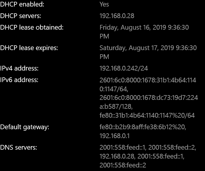

and here are the DNS servers being used
The only DNS servers that should be listed are the IPs of the Pi-hole. Any other listed DNS server will be used and will bypass any blocking provided by the Pi-hole DNS.

That is your problem. Your router is overwriting DNS settings. You need to log into the admin side of the pihole, set a list of forwarders (I recommend OpenDNS personally) and then set your router to look at the IP address of the PiHole.
The way you currently have it set up, DNS is being provided to clients from the router and bypassing the pihole entirely. The router MUST look to the pihole for external DNS forwarding, then the Pihole will try and resolve any outside queries based off of it's internal block table. Pi Hole is just a local DNS server and you need all of your devices to look to it to get the benefit.
