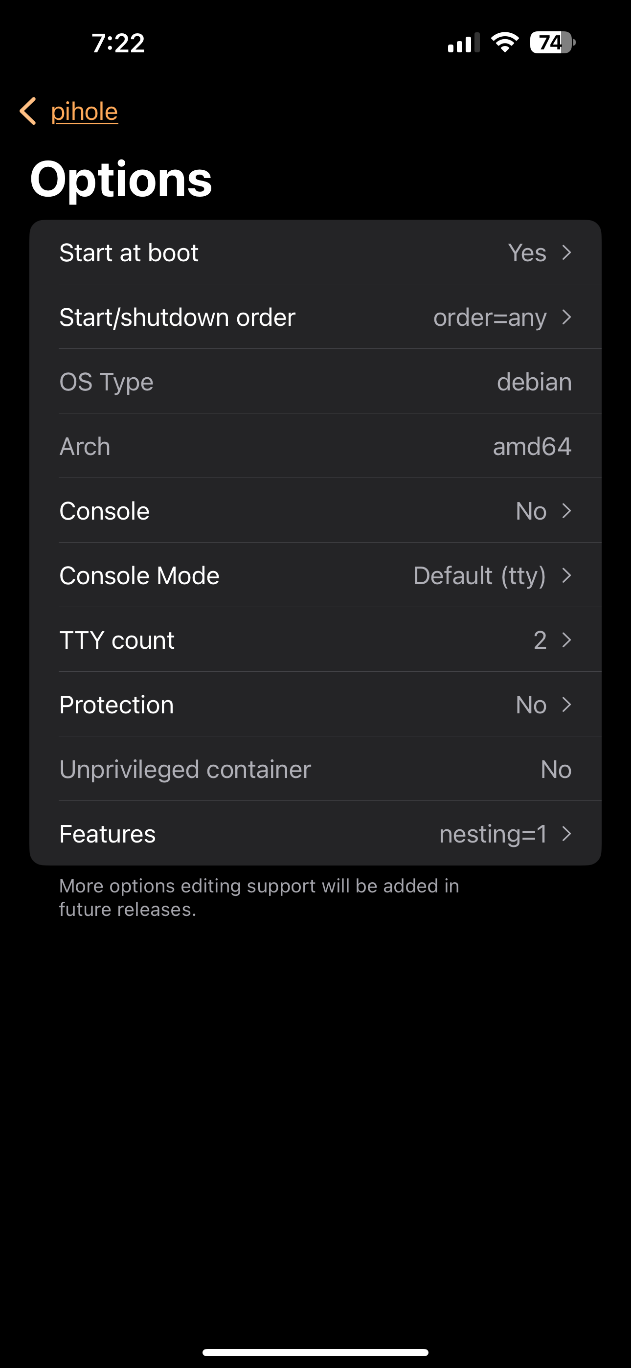

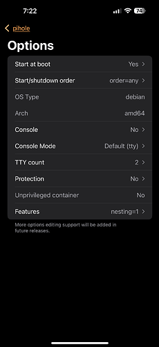

Might be a silly question but have you checked the startup on boot option in the ct itself.
And check if pihole services are enabled
systemctl is-enabled pihole-FTL
If not
systemctl enable pihole-FTL
Thanks for checking - they are both enabled.

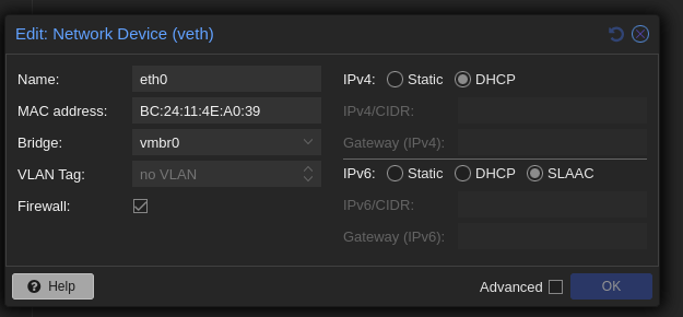

Ok so after another outtage, some frustrating chat with an LLM, old-fashioned Google yielded the issue and answer.
Basically, I noticed that the networking service was hanging, and it turns out it was dhclient -6 which didn't complete. This then prevented the pihole-FTL service from loading. I was fixing it accidentally by killing various processes.
In proxmox, there is a setting to use SLAAC instead of DHCP, as per this post:
This seems to fix the issue (although it persists in the linked post above).
If this doesn't work, there are two more options:
  1. Disable ipv6 on the pihole, which makes sense as I'm only specifying the ipv4 address as the DNS server anyway
  2. Use a static IP address, which again would make sense, although I'm happy with the DHCP reservation on the router.
