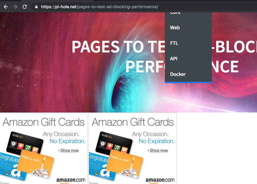

Having tested by visiting https://pi-hole.net/pages-to-test-ad-blocking-performance/ which as you can see still shows some ads:

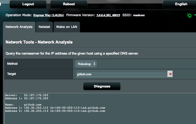

Now as I mentioned earlier, I've had my Asus repeater's DNS IP set to that of the PiHole which seems to responding correctly based on the results of the nslookup query:
So I still can't seem to get why ad blocking is effective intermittently.
From your previous description, ads have never been completely blocked by this Pi-Hole. That indicates that your devices are bypassing Pi-Hole and getting the ad domains from another DNS source. This typically is caused by a router configuration problem.
Do you have IPv6 enabled on your router and clients? That is a common cause for Pi-Hole bypasses.
