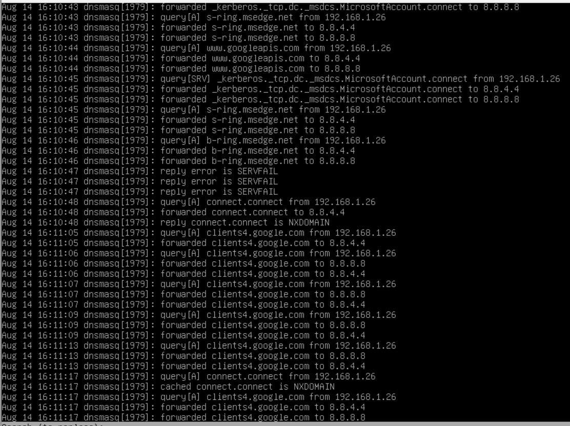

This seems odd. If the DNS traffic was received by Pi-Hole and an IP was returned, then the browser should have connected. What is shown in the pihole.log for these transactions: /var/log/pihole.log
Laptop IP is 192.168.1.26 - i see in the reply SERVFAIL

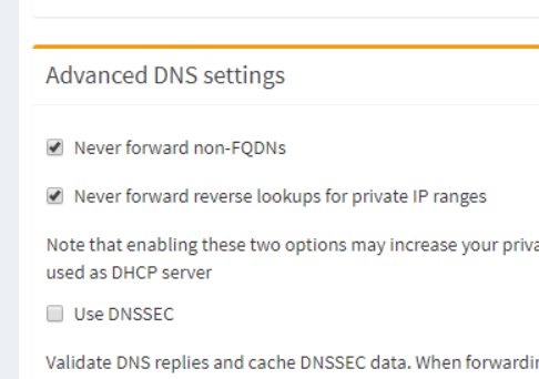

DNSSEC is disabled in my system
