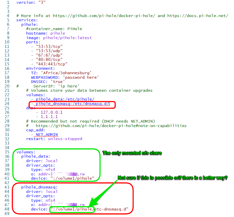

Im trying deploy pi-hole in a portainer stack in a docker swarm. No mounting hte NFS4 share is not the issue as i have the at working, the issue arrives when I try mount a secnd subfolder within the original NFS share. As you may or may no not know, but pi-hole has two volumes that must be mounted, the sceond is a subfolder with in the priamry fold.
The error:
Thanks in advance!

Im not even sure if thats correct, I assumed it made sense. How do poeple mount nfs shares in docker swarm for apps that have more than one share? Mounting two shares makes no sense, mounting one and allow for subfolders makes sense. Where is the best pleace to post to get a answer on this?
