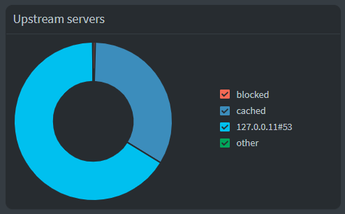

Hi all,

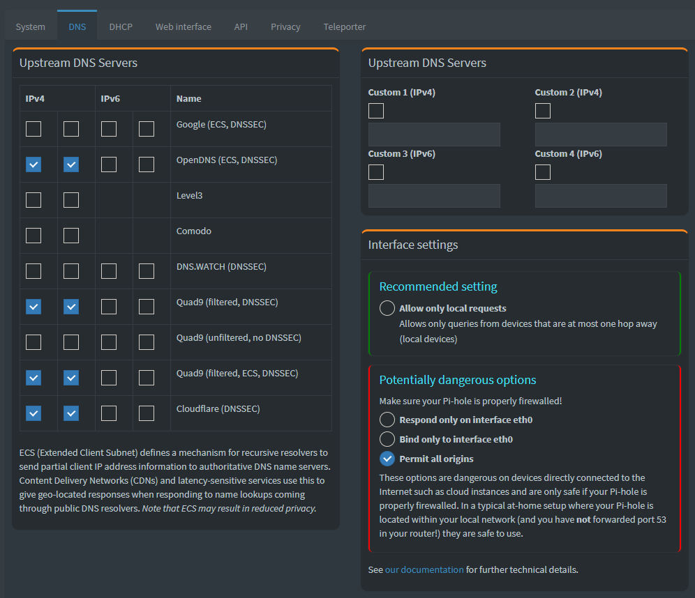

I installed PiHole (Docker Tag [2023.03.1] Pi-hole [v5.16.2] * FTL [v5.22]Web Interface [v5.19] ) in a docker container. I used docker compose. For some reason it seems it always use 127.0.0.11 as a forwarder DNS (refer the attached picture)....ok 127.0.0.11 is the default DNS in a docker container but my expectation was different. I configured OpenDNS and Quad9 as a forwarder DNS so I'm expecting this will be contacted if a resolution is not cached or blocked.

All my containers using macvlan show nameserver 127.0.0.11 in /etc/resolv.conf, but I never saw 127.0.0.11#53 on the web interface. I don't think this is the issue here.

$ dig +short chaos txt servers.bind @192.168.18.125
"127.0.0.11#53 19156 0"
$ dig +short chaos txt servers.bind @192.168.18.253
"127.0.0.11#53 19183 0"
For my understanting. I'm expecting PiHole use the Upstream DNS configured and not the default DNS in resolv.conf. Am I wrong? Anyway at the moment i tried and PiHole is blocking via lists/regex and not per upstream dns.
