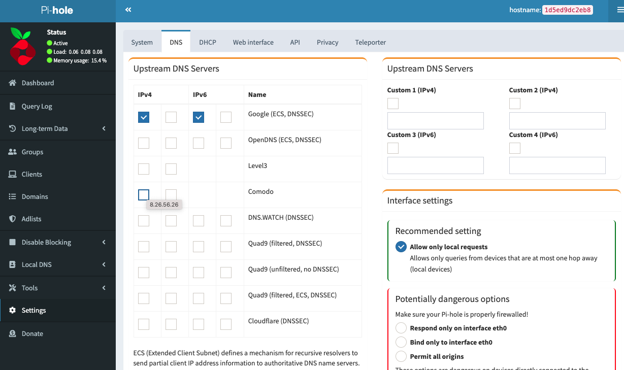

No configuration change is made for pi-hole and having the following setup for DNS
