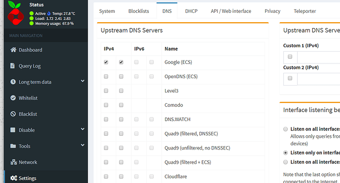

So I have a pihole setup in a docker container using macvlan bridging. I am using pihole as my dhcp server as opposed to my router, and it mostly works. However, I have a strange issue. My machine not pass dns traffic unless I manually enter a known working DNS server.
Like this -
That is the only way my traffic will pass. Which is odd, because I have pihole set up to use the same exact google dns server as it's upstream -
