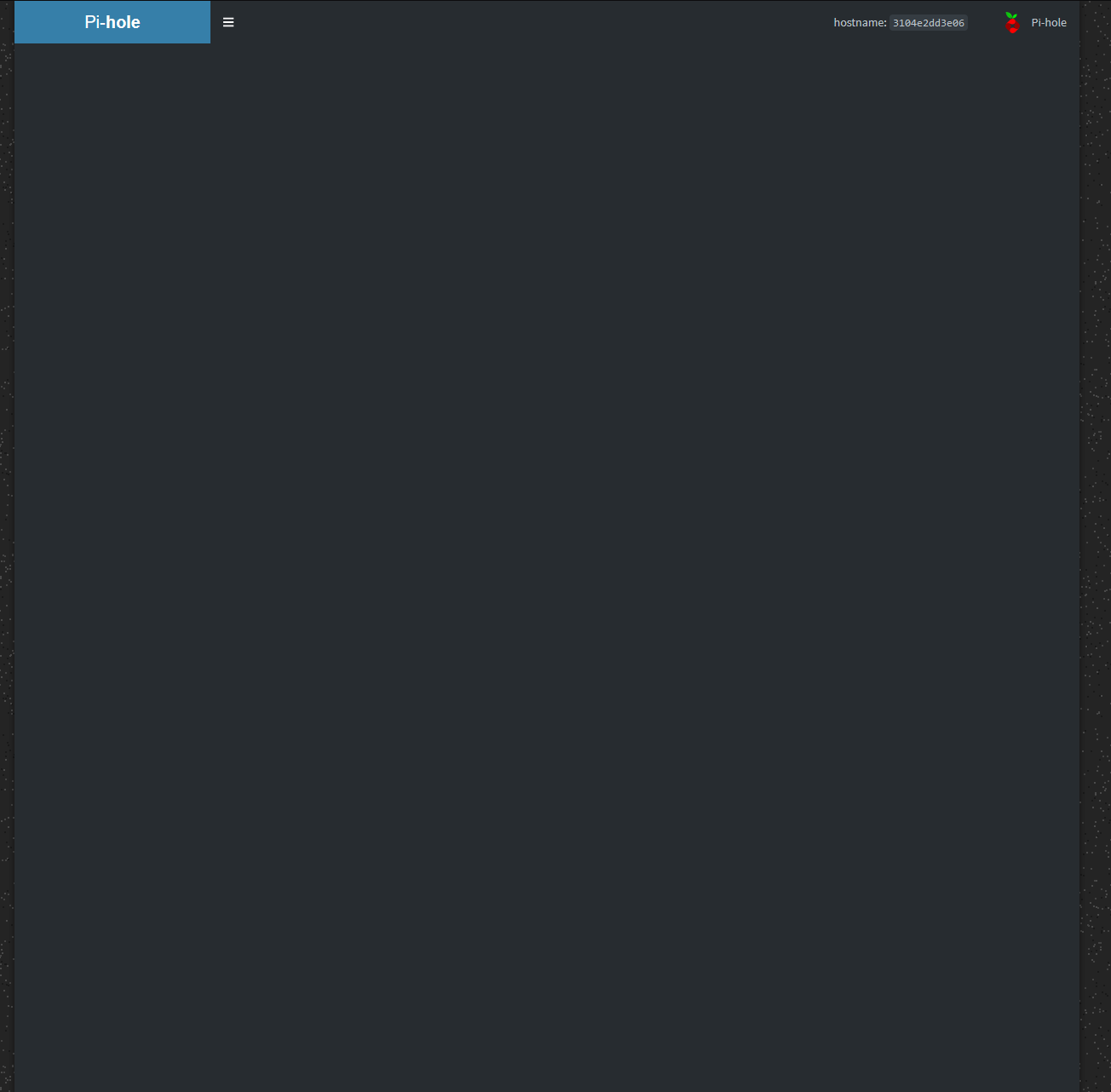

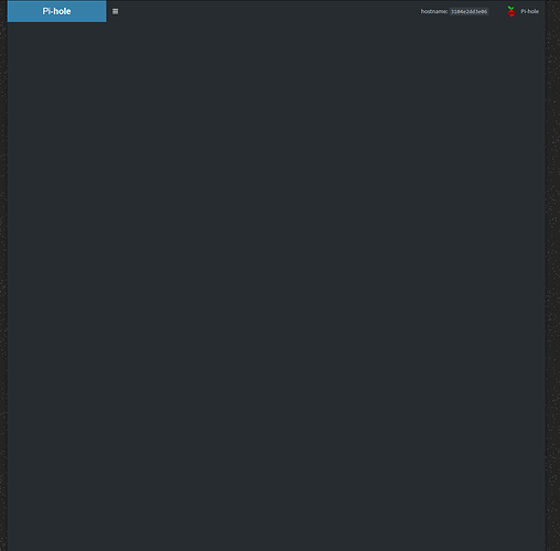

the problem is the web interface is not working. It loads but it's completely empty.

   [1935-06-02 16:48:20.000 557M] Creating mutex
   [1970-03-09 23:52:09.1764755 557M] Starting config file parsing (/etc/pihole/pihole-FTL.conf)
   [1970-01-01 01:00:00.000 557M]    SOCKET_LISTENING: only local
   [1935-06-02 16:48:44.000 557M]    AAAA_QUERY_ANALYSIS: Show AAAA queries
   [1935-06-02 16:48:44.000 557M]    MAXDBDAYS: max age for stored queries is 365 days
   [1970-01-01 01:00:00.000 557M]    RESOLVE_IPV6: Resolve IPv6 addresses
   [1970-01-01 01:00:00.000 557M]    RESOLVE_IPV4: Resolve IPv4 addresses
   [1970-01-01 01:00:00.000 557M]    DBINTERVAL: saving to DB file every minute
   [1970-01-01 01:00:00.000 557M]    DBFILE: Using /etc/pihole/pihole-FTL.db
   [1935-06-02 16:48:44.000 557M]    MAXLOGAGE: Importing up to 24.0 hours of log data
   [1970-01-01 01:00:00.000 557M]    PRIVACYLEVEL: Set to 0
   [1935-06-02 16:48:44.000 557M]    IGNORE_LOCALHOST: Show queries from localhost
   [2025-12-03 10:50:56.-1224825 557M]    BLOCKINGMODE: Null IPs for blocked domains
   [1935-06-02 16:48:44.000 557M]    ANALYZE_ONLY_A_AND_AAAA: Disabled. Analyzing all queries
   [1970-01-01 01:00:00.000 557M]    DBIMPORT: Importing history from database
   [1970-01-01 01:00:00.000 557M]    PIDFILE: Using /run/pihole-FTL.pid
   [1970-01-01 01:00:00.000 557M]    PORTFILE: Using /run/pihole-FTL.port
   [1970-01-01 01:00:00.-1226499 557M]    SOCKETFILE: Using /run/pihole/FTL.sock
   [1935-06-02 16:48:04.000 557M]    SETUPVARSFILE: Using /etc/pihole/setupVars.conf
   [1935-06-02 16:48:04.000 557M]    MACVENDORDB: Using /etc/pihole/macvendor.db
   [1935-06-02 16:48:04.000 557M]    GRAVITYDB: Using /etc/pihole/gravity.db
   [1970-01-01 01:00:13.000 557M]    PARSE_ARP_CACHE: Active
   [1935-06-02 16:48:44.000 557M]    CNAME_DEEP_INSPECT: Active
   [1935-06-02 16:48:44.000 557M]    DELAY_STARTUP: No delay requested.
   [1935-06-02 16:48:44.000 557M]    BLOCK_ESNI: Enabled, blocking _esni.{blocked domain}
   [1935-06-02 16:48:44.000 557M]    NICE: Cannot change niceness to -10 (permission denied)
   -----tail of FTL.log------
   [1935-06-02 16:47:56.000 557M] DB warn: TIMESTAMP should be larger than 01/01/2017 but is 1126560000
   [1935-06-02 16:47:56.000 557M] Imported 0 queries from the long-term database
   [1970-01-01 01:00:00.-1091347 557M]  -> Total DNS queries: 0
   [1935-06-02 16:50:44.-1091347 557M]  -> Cached DNS queries: 0
   [1935-06-02 16:50:44.-1091347 557M]  -> Forwarded DNS queries: 0
   [1935-06-02 16:50:44.-1091347 557M]  -> Blocked DNS queries: 0
   [1935-06-02 16:50:44.-1091347 557M]  -> Unknown DNS queries: 0
   [1935-06-02 16:50:44.-1091347 557M]  -> Unique domains: 0
   [1935-06-02 16:50:44.-1091347 557M]  -> Unique clients: 0
   [1935-06-02 16:50:44.000 557M]  -> Known forward destinations: 0
   [1970-09-15 19:57:04.1764755 557M] Successfully accessed setupVars.conf
   [1931-03-11 03:52:44.000 557M] listening on 0.0.0.0 port 53
   [1935-06-02 16:44:12.000 557M] listening on :: port 53
   [1974-01-18 17:15:13.-1226504 557M] PID of FTL process: 557
   [1970-01-01 01:00:00.-1229161 557/T590] Listening on port 4711 for incoming IPv4 telnet connections
   [1970-09-15 19:12:45.-1225822 557M] INFO: FTL is running as user pihole (UID 999)
   [1970-01-01 01:00:00.22290 557M] Reloading DNS cache
   [1970-01-01 01:00:00.000 557/T592] Listening on Unix socket
   [1929-04-06 23:20:52.4564 557/T593] Compiled 0 whitelist and 0 blacklist regex filters for 0 clients in 6698738775.2 msec
   [1970-01-10 03:27:12.000 557/T593] Blocking status is enabled
   [1970-01-01 01:00:00.000 557M] Reloading DNS cache
   [1929-04-07 10:19:24.5216 557/T593] SQLite3 message: file renamed while open: /etc/pihole/gravity.db (28)
   [1929-04-08 19:59:16.4564 557/T593] Compiled 0 whitelist and 0 blacklist regex filters for 0 clients in 6698738775.2 msec
   [1970-03-19 15:49:44.001 557M] WARN: Found database entries in the future (2025-12-03 10:55:00 (1764755700), last timestamp for importing: 1970-03-15 12:55:00 (6350100)). Your over-time statistics may be incorrect (found in src/dnsmasq_interface.c:671)
   [1970-01-01 01:00:00.000 557M] New upstream server: 8.8.8.8:53 (0/1024)
   [1970-01-01 01:00:00.000 557M] New upstream server: 8.8.4.4:53 (1/1024)
   [1935-06-02 16:20:28.22356 557M] Resizing "FTL-dns-cache" from 4096 to (512 * 16) == 8192 (/dev/shm: 1.3MB used, 67.1MB total, FTL uses 1.3MB)
   [1935-06-02 16:20:28.22356 557M] Resizing "FTL-dns-cache" from 8192 to (768 * 16) == 12288 (/dev/shm: 1.3MB used, 67.1MB total, FTL uses 1.3MB)
   [1935-06-02 16:20:28.22356 557M] Resizing "FTL-dns-cache" from 12288 to (1024 * 16) == 16384 (/dev/shm: 1.3MB used, 67.1MB total, FTL uses 1.3MB)
   [1931-02-18 14:37:04.-1091348 557M] Rate-limiting 172.19.0.1 for at least 1095940183 seconds
*** [ DIAGNOSING ]: contents of /dev/shm
-rw------- 1 pihole pihole 324K Jul 24  2022 /dev/shm/FTL-clients
-rw------- 1 pihole pihole 244 Jul 24  2022 /dev/shm/FTL-counters
-rw------- 1 pihole pihole 16K Jul 24  2022 /dev/shm/FTL-dns-cache
-rw------- 1 pihole pihole 20K Jul 24  2022 /dev/shm/FTL-domains
-rw------- 1 pihole pihole 56 Jul 24  2022 /dev/shm/FTL-lock
-rw------- 1 pihole pihole 12K Jul 24  2022 /dev/shm/FTL-overTime
-rw------- 1 pihole pihole 4.0K Jul 24  2022 /dev/shm/FTL-per-client-regex
-rw------- 1 pihole pihole 176K Jul 24  2022 /dev/shm/FTL-queries
-rw------- 1 pihole pihole 12 Jul 24  2022 /dev/shm/FTL-settings
-rw------- 1 pihole pihole 80K Jul 24  2022 /dev/shm/FTL-strings
-rw------- 1 pihole pihole 604K Jul 24  2022 /dev/shm/FTL-upstreams
*** [ DIAGNOSING ]: contents of /etc
-rw-r--r-- 1 root root 37 Jul 24  2022 /etc/dnsmasq.conf
   conf-dir=/etc/dnsmasq.d
   user=pihole
-rw-rw-r-- 1 root 1000 38 Jul 24  2022 /etc/resolv.conf
   nameserver 127.0.0.11
   options ndots:0
*** [ DIAGNOSING ]: Pi-hole diagnosis messages
   count   last timestamp       type                  message                                                       blob1                 blob2                 blob3                 blob4                 blob5
   1       1935-06-02 16:51:56  RATE_LIMIT            172.19.0.1                                                    1000                  60
*** [ DIAGNOSING ]: Locale
    LANG=
-rw-r--r-- 1 pihole pihole 1.5M Jul 24  2022 /var/log/pihole/pihole.log
   -----head of pihole.log------
   Feb 22 15:45:43 dnsmasq[557]: started, version pi-hole-2.87test8 cachesize 10000
   Jan  1 01:00:30 dnsmasq[557]: compile time options: IPv6 GNU-getopt no-DBus no-UBus no-i18n IDN DHCP DHCPv6 Lua TFTP no-conntrack ipset no-nftset auth cryptohash DNSSEC loop-detect inotify dumpfile
   Sep 16 03:39:44 dnsmasq[557]: using nameserver 8.8.8.8#53
   Jan  1 01:00:30 dnsmasq[557]: using nameserver 8.8.4.4#53
   Jan  1 01:00:30 dnsmasq[557]: using only locally-known addresses for onion
   Jan  1 01:00:30 dnsmasq[557]: using only locally-known addresses for bind
   Jan  1 01:00:30 dnsmasq[557]: using only locally-known addresses for invalid
   Jan  1 01:00:30 dnsmasq[557]: using only locally-known addresses for localhost
   Jan  1 01:00:30 dnsmasq[557]: using only locally-known addresses for test
   Dec  3 10:50:56 dnsmasq[557]: read /etc/hosts - 7 addresses
   Dec  3 10:50:56 dnsmasq[557]: read /etc/pihole/custom.list - 0 addresses
   Dec  3 10:50:56 dnsmasq[557]: read /etc/pihole/local.list - 0 addresses
   Sep 17 23:05:52 dnsmasq[557]: query[PTR] 1.0.18.172.in-addr.arpa from 172.19.0.1
   Feb 27 07:21:32 dnsmasq[557]: forwarded 1.0.18.172.in-addr.arpa to 8.8.8.8
   Jan  1 01:00:30 dnsmasq[557]: forwarded 1.0.18.172.in-addr.arpa to 8.8.4.4
   Jan  1 01:00:00 dnsmasq[557]: reply 1.0.18.172.in-addr.arpa is NXDOMAIN
   Jun  2 16:35:40 dnsmasq[557]: query[PTR] 2.0.18.172.in-addr.arpa from 172.19.0.1
   -----tail of pihole.log------
   Jan  1 01:00:00 dnsmasq[557]: config error is REFUSED (EDE: blocked)
   Mar 14 15:14:24 dnsmasq[557]: Rate-limiting 251.7.18.172.in-addr.arpa is REFUSED (EDE: blocked)
   Jan  1 01:00:00 dnsmasq[557]: query[PTR] 252.7.18.172.in-addr.arpa from 172.19.0.1
   Mar 14 15:14:24 dnsmasq[557]: Rate-limiting 252.7.18.172.in-addr.arpa is REFUSED (EDE: blocked)
   Jan  1 01:00:00 dnsmasq[557]: query[PTR] 253.7.18.172.in-addr.arpa from 172.19.0.1
   Mar 14 15:14:24 dnsmasq[557]: Rate-limiting 253.7.18.172.in-addr.arpa is REFUSED (EDE: blocked)
   Jan  1 01:00:00 dnsmasq[557]: query[PTR] 254.7.18.172.in-addr.arpa from 172.19.0.1
   Mar 14 15:14:24 dnsmasq[557]: Rate-limiting 254.7.18.172.in-addr.arpa is REFUSED (EDE: blocked)
   Jan  1 01:00:00 dnsmasq[557]: query[PTR] 255.7.18.172.in-addr.arpa from 172.19.0.1
   Mar 14 15:14:24 dnsmasq[557]: Rate-limiting 255.7.18.172.in-addr.arpa is REFUSED (EDE: blocked)
   Jan  1 01:00:00 dnsmasq[557]: query[PTR] 0.8.18.172.in-addr.arpa from 172.19.0.1
   Mar 14 15:14:24 dnsmasq[557]: Rate-limiting 0.8.18.172.in-addr.arpa is REFUSED (EDE: blocked)
   Jan  1 01:00:00 dnsmasq[557]: query[PTR] 1.8.18.172.in-addr.arpa from 172.19.0.1
   Mar 14 15:14:24 dnsmasq[557]: Rate-limiting 1.8.18.172.in-addr.arpa is REFUSED (EDE: blocked)
[✓] ** FINISHED DEBUGGING! **
    * Error message: curl: (28) Resolving timed out after 1091946531065 milliseconds
[✗]  There was an error uploading your debug log.
   * A local copy of the debug log can be found at: /var/log/pihole/pihole_debug.log
