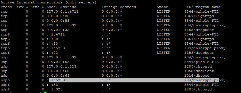

Please generate a fresh debug log, upload it and post the token here. Also, please post the output of the following command from the Pi terminal:
sudo netstat -nltup | grep 'Proto\|:53 \|:5053 \|:5353 \|:5335 \|:8953 \|:67 \|:80 \|:471'
https://tricorder.pi-hole.net/fv3if7ow64
debug log, is made when it is working correctly
This may be due to DNSCrypt using the port on startup prior to fully reading its configuration file that moves it to port 5333.
