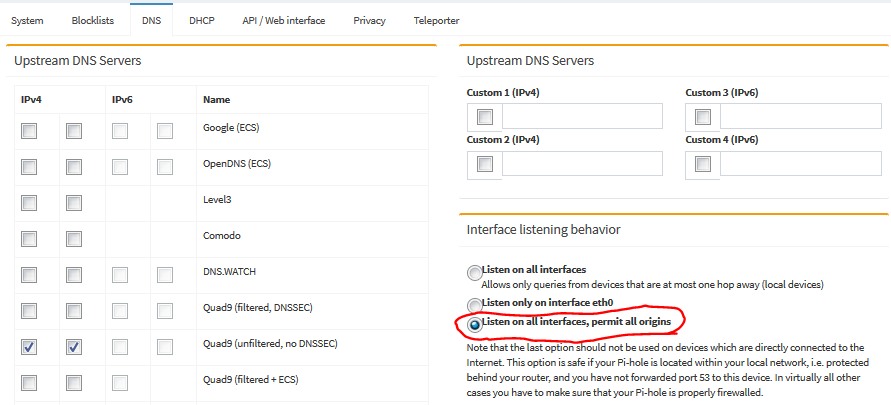

If configured to lets say only listen on the eth0 or wlan0 interface, querying Pi-hole's DNS on the other interfaces, like for example the VPN's tun0 IP, will fail.
To have Pi-hole answer DNS queries on all interfaces, change below Pi-hole setting on the web GUI:
Test on a client PC with the nslookup tool (Windows/Linux/MacOS).

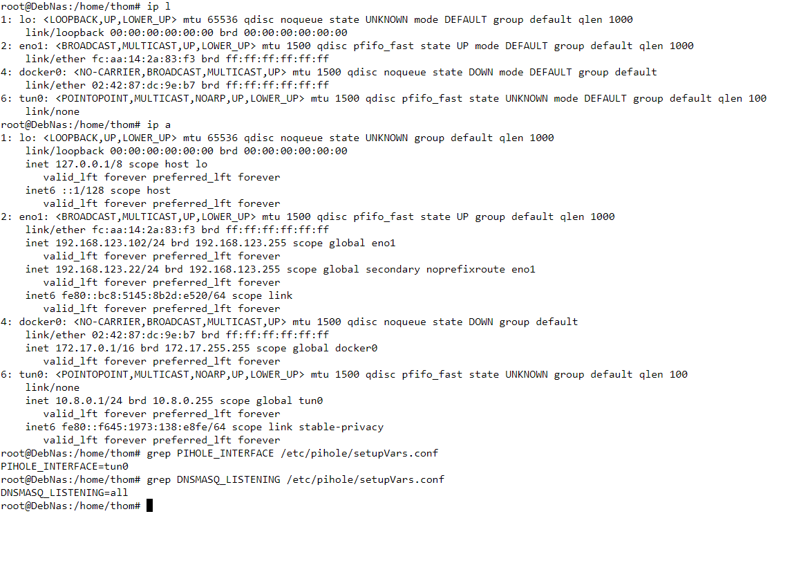

Here's the result of these commands:
It seems setupVars.conf points to the wrong, well, "not correctly to all interfaces".
nslookup fails no matter what from client
Edit: Changing it to eno1 and restarting the DNS client didn't affect anything as far as I can see.
Output looks good.

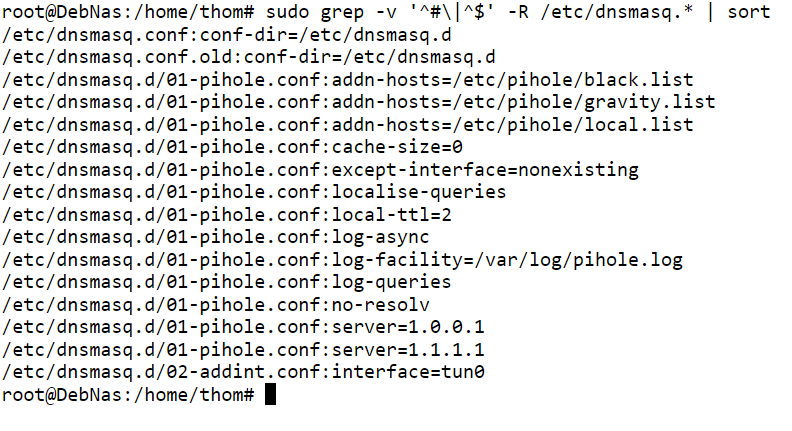

Maybe a rogue config file messing things up:
sudo grep -v '^#\|^$' -R /etc/dnsmasq.* | sort
If output from above one contains a line with an interface= directive, you can expect Pi-hole to not reply on all interfaces.
There is one.
That rogue 02-addint.conf file is probably the cause.
Move it out of there to your home folder for backup/reference:
sudo mv /etc/dnsmasq.d/02-addint.conf ~
And restart the daemon:
sudo service pihole-FTL restart
Yes! That did it!
