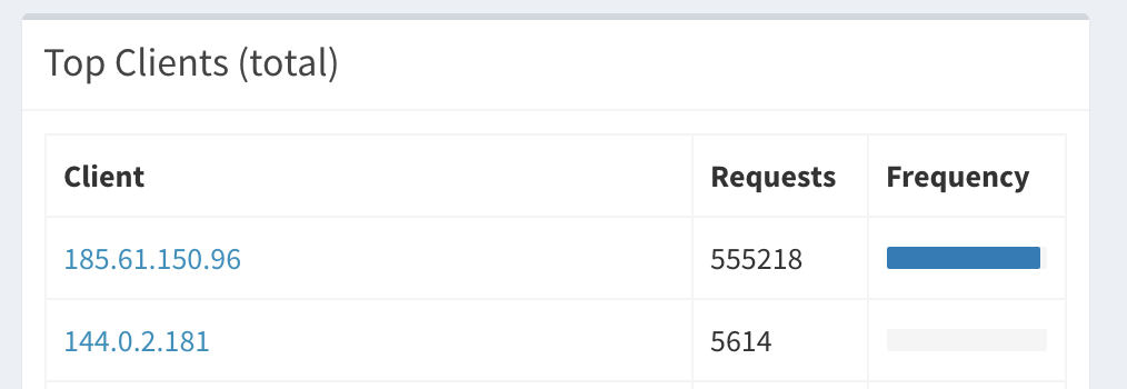

Thats what i got on this xx.xxx.2.73. How they got my ip? Server was running from about 15 days.
And another server same issue, with in 24 hours of pihole -d command.
The number of IPv4 addresses is countable. It may be less than you think and already too few for all Internet capable devices worldwide. Because there are fewer than 4.3 addresses available, depletion has been anticipated since the late 1980s, when the Internet started to experience dramatic growth. There are services out there that scan the entire Internet in a day (or even less), quickly discovering any new machines.
Please note: Security by obfuscation is not only a bad idea, but has been proven repeatedly to not work at all with IPv4 addresses.
