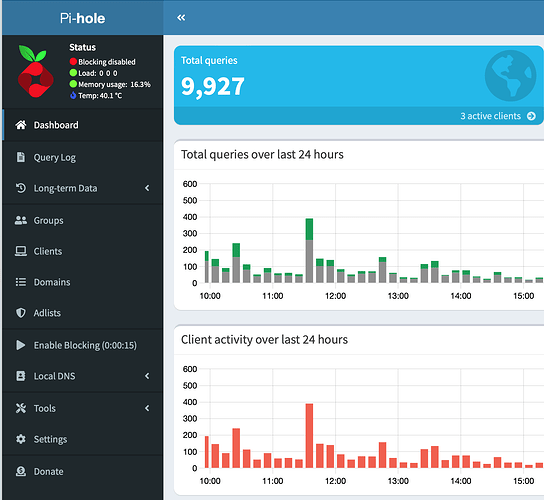

If you disable from the web admin GUI, there is a countdown timer. In this example, I disabled for 30 seconds and took the screen capture about halfway through:
That's the exact data I am looking for, but I need to be able to pull it either from REST API or CLI or a file. Is there a way? I also noticed that when pihole is disabled from CLI (pihole disable 30s) the web interface does not have a counter.
