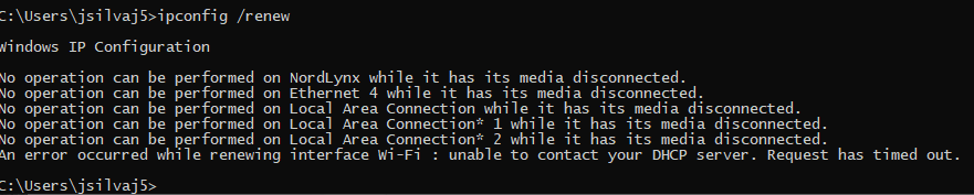

I tried that when it happened but it couldn't reach the dhcp server.
media disconnected
That screenshot indicates a hardware problem with your PC's network equipment. Either your Ethernet cable or ports are faulty or unplugged, or your WiFi is dropping connections (which there are plenty of potential causes for).
That would be in line with your observation that other devices have no problem with Pi-hole's DHCP or DNS, so it doesn't look like a Pi-hole issue.
I assumed it said that because i was not using those connections.
Let me investigate further on the microsoft support page.
I agree, this does not look like a bug.
unable to contact your DHCP server. Request has timed out.
This is the problem.
