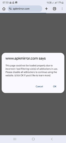

Pihole detected on apkmirror
I should access APK mirror.
Example url:
https://www.apkmirror.com/
From either chrome or firefox, from my Note20ultra android 13 phone.
I get errors that im using adblocker...as if it detects pihole somehow...
(It worked in the past).
Note: I did check the query list, it seems apkmirror is ok...
https://tricorder.pi-hole.net/THJM9bwz/

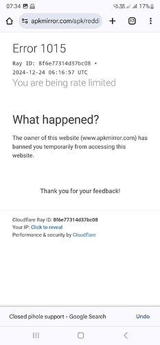

Seems like one of the block lists in use could be the issue. Have you tried (after a while, as there was a tempban in place) using the disable pihole in the webgui to see if that made a difference?
If the site works then it's likely that the filters in use on your setup were causing the issue.

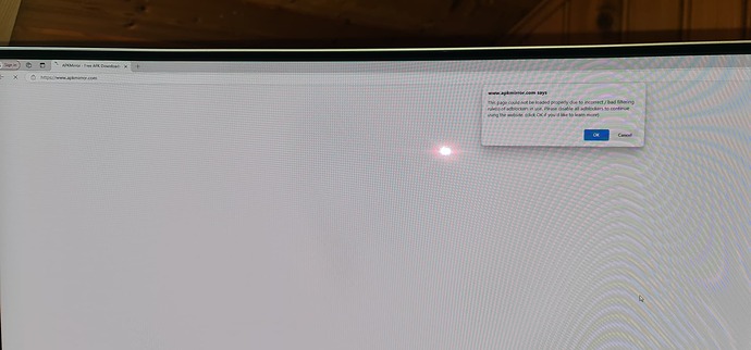

So apkmirror works from my pc in chrome and firefox, both with ublock origin and ghostery.
From edge it fails too:

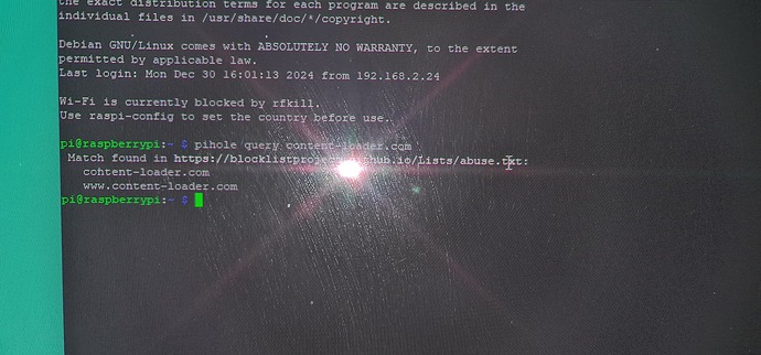

From the pihole you can run pihole query content-loader.com and see what ad list this is part of or if its a regex entry.
When you remove it / or whitelist it make sure to clear cookies on what ever machine you test.

It seems with your command that the same content is blocked still now but it works properly now...
Anyway unfortunately its a bit of mystery and I managed to make it work not knowing how exactly...
