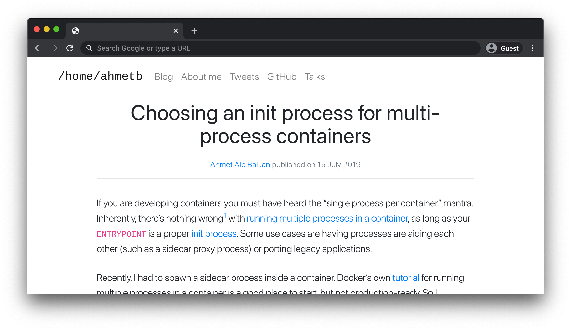

You're missing all of the startup scripting from the pihole/pihole image.
Also, generally not a great idea to run services like that in the final command.
If you really want only one docker container, then using a supervisor like something described here:
Also, you are using docker-compose, much better off using the standard docker images for each service and running many services.
