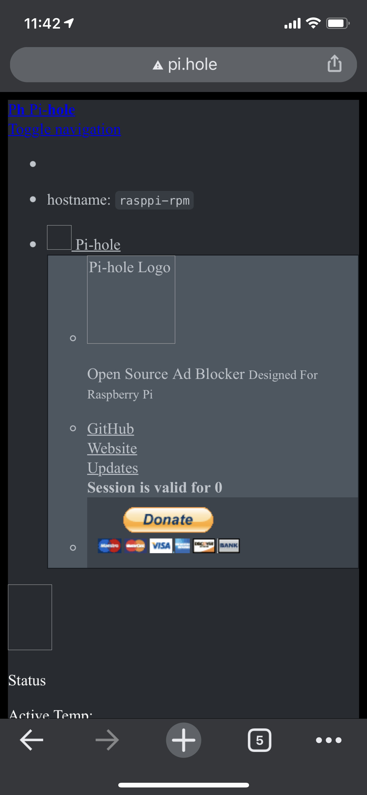

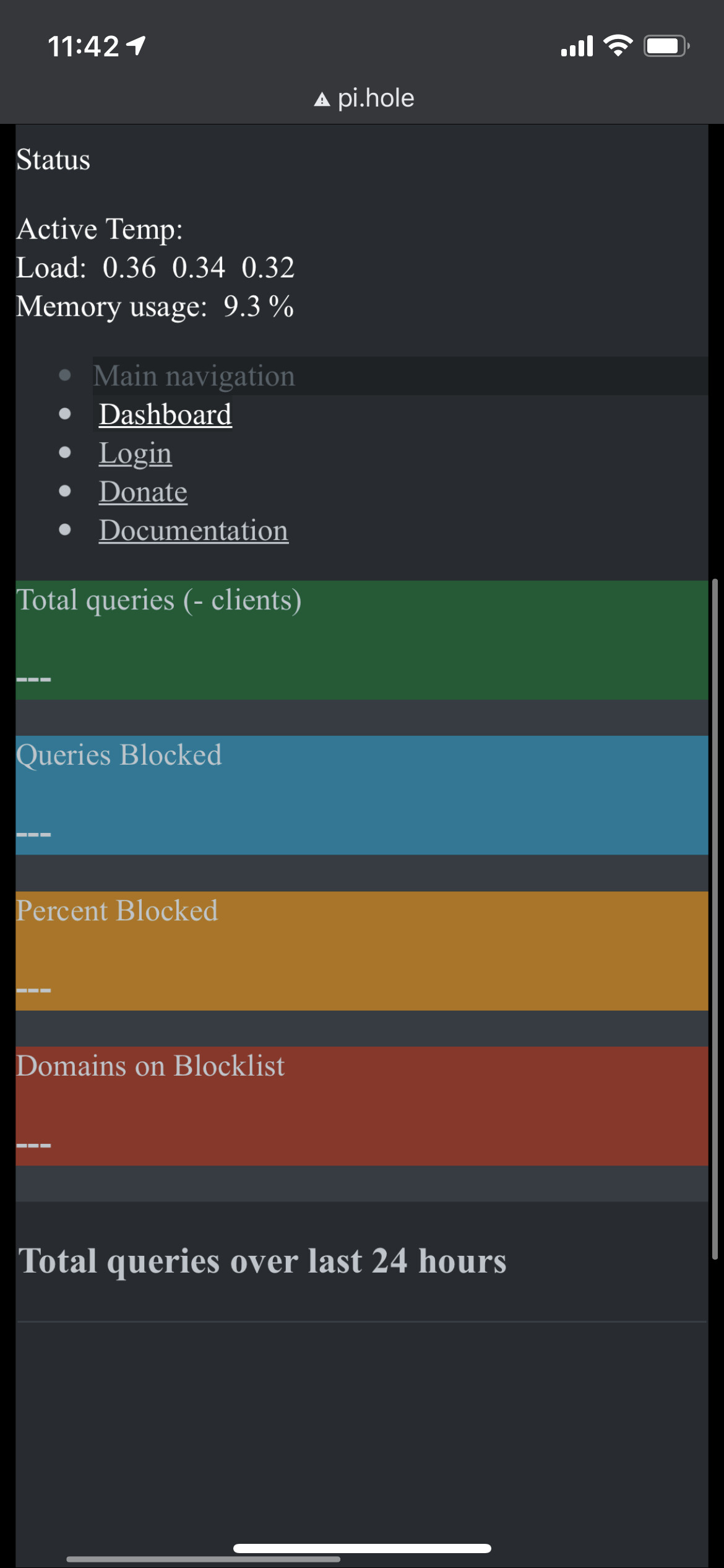

Pihole Dashboard Partially loading and unusable
Dashboard loads as expected
Multiple devices
Multiple browsers
Incognito or not
Unlock origin disabled or not
Still occurs after a pihole repair

Another place to check - developer console of your web browser. Look for any errors in the console or network tabs, specifically scripts not loading. From the screenshots it looks as though the CSS is unable to load...
Updated fresh debug for the instance (remote from main / local to parents) with the broken UI is 2e55heu5qk
Dev Console shows no errors
Networking shows 200s (OK) or 304 (not modified) if cached for the network calls (cs and js)
js is not blocked

At this point going to try a pihole -r reinstall on the 192.168.2 pi as repairs and multiple reboots have done nothing
Just for shits and giggles... Try the nuclear option on the web interface instead:
sudo rm -rf /var/www/html/admin
sudo git clone https://github.com/pi-hole/adminLTE /var/www/html/admin
I guess there is also the possibility of file system issues, too - I guess not so much an easy fix remotely.
Well damn, was just gonna say a reinstall did not fix it (spoiler: it did not)
But nuclear option on webui seems to have did it.
Don't know why/how, but won't question it
Thanks!
It's possibly (but not definitely) indicative of a file system issue. If it were me, and it weren't too much hassle, I'd reflash the SD card and start again
