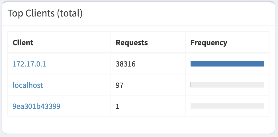

Pihole Dashboard only shows 2 clients and doesn't seem to be working
I am running PiHole from my Mac using docker:
docker run -d --name pihole -e ServerIP=192.168.1.226 -e TZ=America/Costa_Rica -e WEBPASSWORD=xxxx@ -e DNS1=1.1.1.1 -e DNS2=1.0.0.1 -p 80:80 -p 53:53/tcp -p 53:53/udp -p 443:443 -v ~/pihole/:/etc/pihole/ --dns=127.0.0.1 --dns=1.1.1.1 --cap-add=NET_ADMIN --restart=unless-stopped pihole/pihole:latest
I have changed my router's DNS to my mac's ipaddress. Everything looks to be working but the Dashboard only shows 2 clients and I am also seeing ads :frowning:
Please help!
Should be able to see more than 2 clients
_Only 2 clients are shown with odd IP address :frowning: _

I need to correct myself, PiHole is working, as I have seen ads being blocked. It is just the clients that show up that is acting weird, like if the Docker container ipaddress is the solely client
If all the requests are being passed through Docker to get to Pi-hole, this is expected.
I was afraid you were going to say that :cry: thanks for the help jfb
