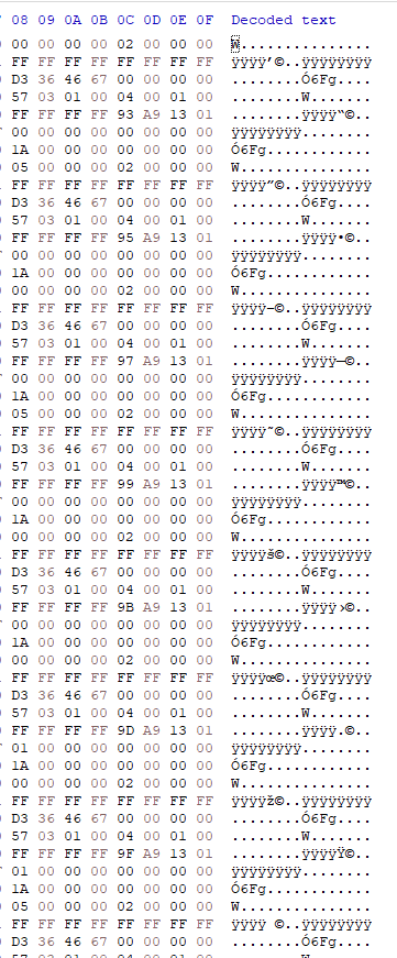

I open the FTL-queries file with a Hex Editor and the only thing i see are repeated patterns

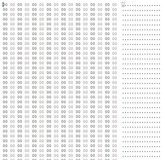

To add further to my questions. This file i downloaded and it was 750MB.
In Hex Editor it has many empty lines
I edited the file and saw that these empty lines are 250MB if you remove the lines with data.
Very strange
13,348,191 DNS requests for 13 unique domains in 6 hours, originating from 3 clients - this is indeed client misbehaviour, as they are apparently not respecting TTLs, and their excessive and unnecessary DNS requests also contribute towards network congestion.

Please take a look to this FTL-queries file behavior especially the empty lines that are taking so much space and the repeated patterns. Maybe refactor some things to optimize it further. I am just adding some feedback.
