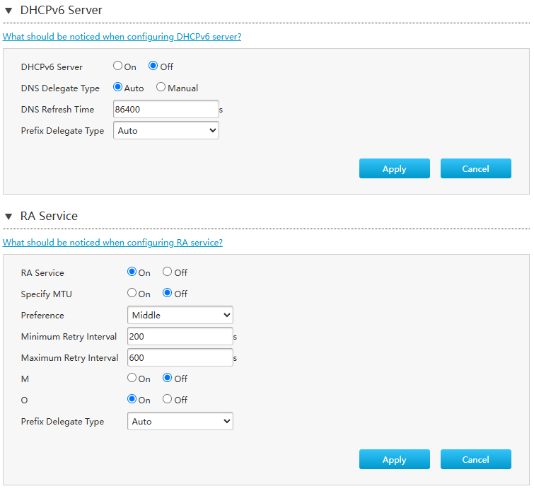

These are the settings on my router ZTE H6645P:
Settings
I am a newbie of IPv6, so I don't know if this is the intended behaviour, but I suppose If a device tries to use the PiHole as a gateway, the connection would fail, so I would like to stop PiHole form doing it.

That’s the reason why I wanted to use PiHole as a DHCP server, my router will let me set IPv4 and IPv6 DNS addresses, but it will also forcefully broadcast itself alongside the DNS I have set, leading the devices to be able to bypass PiHole.
The router will only let me disable RA service entirely, as shown in my router’s screenshot above, but this will prevent it from showing as a gateway, so if I enable SLAAC+RA in PiHole’s DHCP settings, the only gateway for IPv6 listed will be the PiHole, if I disable it, there will be no IPv6 gateway, both situations leading to no connection.

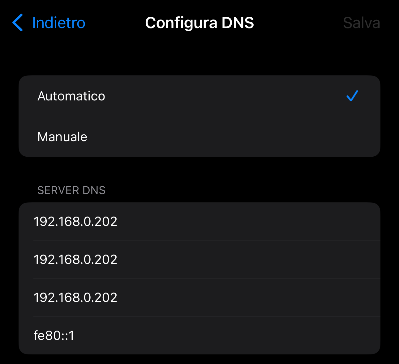

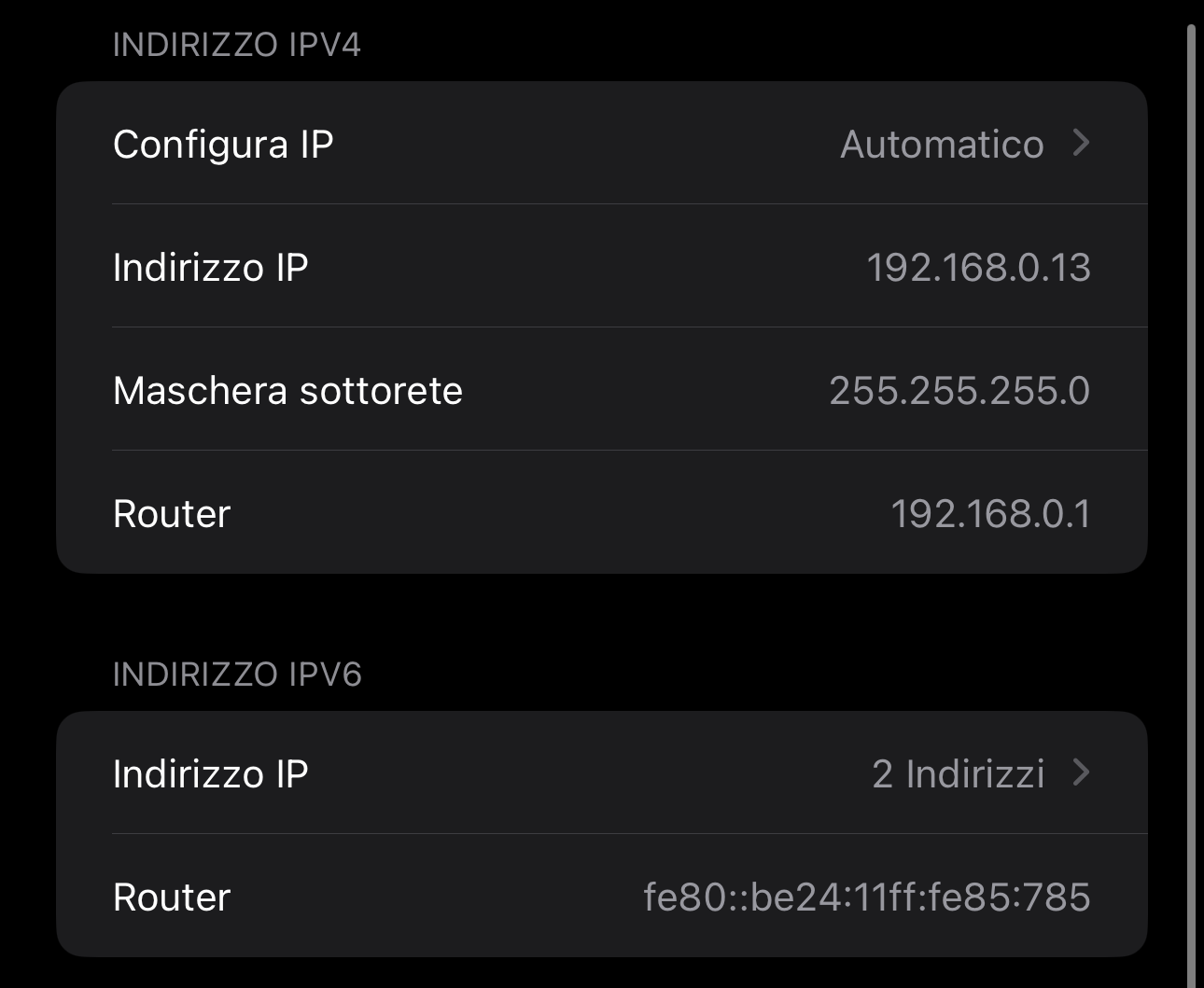

The problem doesn’t appear to be Windows specific, as the same happens with iOS devices:
Also, if I disable SLAAC+RA in PiHole’s DHCP settings, leaving the PiHole’s IPv4 address as the only DNS server, Windows will correctly list only that DNS server, but iOS will also list my router’s IPv6 address.
I think that is probably an iOS problem, maybe it adds the gateway as a DNS address if it doesn’t find any IPv6 DNS servers.

I posted it in my first post, I'll post it back here:
My router is a ZTE H6645P

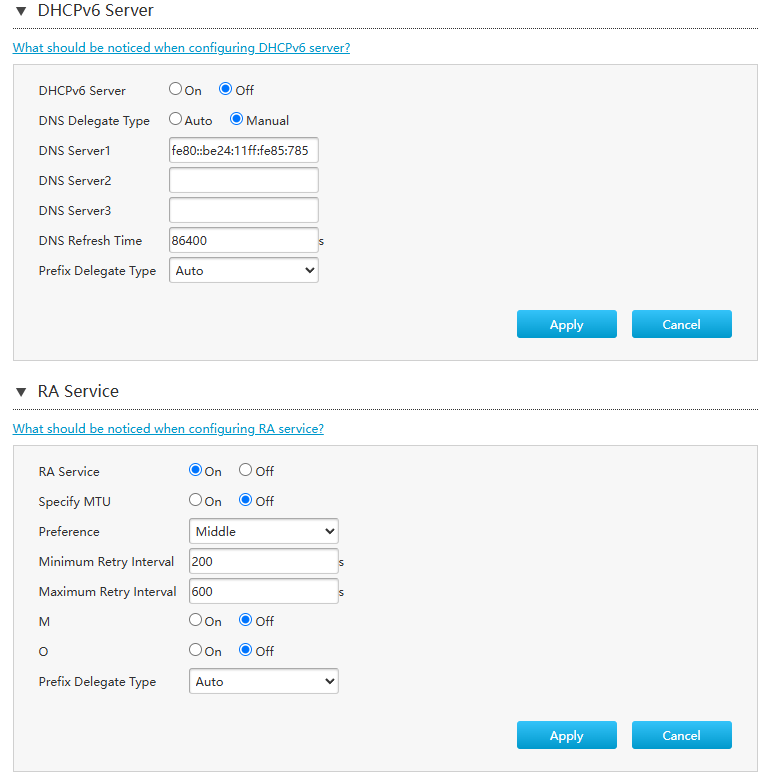

For that model, we have figured a configuration that would not advertise an IPv6 DNS server address.
You should also switch DNS Delegate Type to Manual and not set any DNS servers.
Ok, I have set the router as per your instructions.
I am forced to set one DNS server address at least, otherwise it won't let me apply the settings, so I put the PiHole IPv6.
Here is how the router is configured now:

On iOS unfortunately, the router IPv6 address is still listed:
In absence of any new RDNSS RAs, your iOS device probably held on to that LLA for as long as the DNS Refresh Time allowed - judging by your screenshot, that would be 86,400 seconds (a day).
