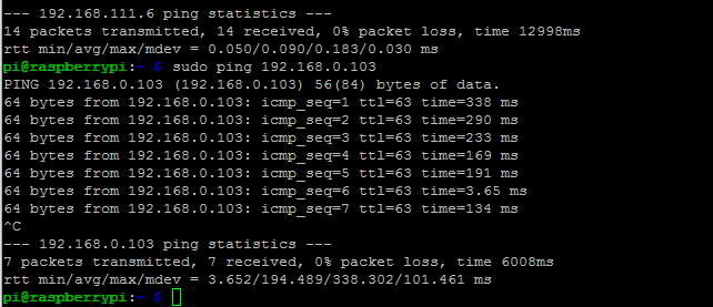

Thank you for everything. Yes, I can indeed reach the pihole from any wireless client in PING and also ping a wireless client from the Pihole as well. Worked perfectly.
192.168.111.6 being the wired network and the pihole's address, and 192.168.0.103 being the wireless client. Worked both ways. As to "Secondary" DNS, should I just delete the Google 8.8.8.8 from my router settings for DNS?

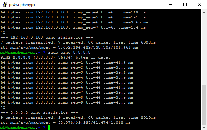

Okay, thanks also for posting the image. There is anyhow something wrong with your network - you need around 200 milliseconds to reach the device within your network. I get even faster readings when I ping to the other side of the globe (within my home network everything is < 1 milliseconds, regardless if wired or wireless or in between). There seems to be something strange going on. Please test if you can reach Google faster (ping 8.8.8.8).
I see only about 10 milliseconds:

Yes. It might just be that the answer from Google's DNS servers comes in much faster (because of your strange slow inter-link to the wired network) and therefore the Pi-hole DNS server is simply skiped because the wireless clients think it is broken or something like that.
Do you have Linux clients on the wireless network or which OS do you have (so we can figure which test commands to use)?
I have Android clients on the wireless mainly with my wireless video clients. I can test with windows, however. I did the ping from Putty to Google DNS and the result is below. My Pi is plugged into a switch plugged into my router, along with other devices.

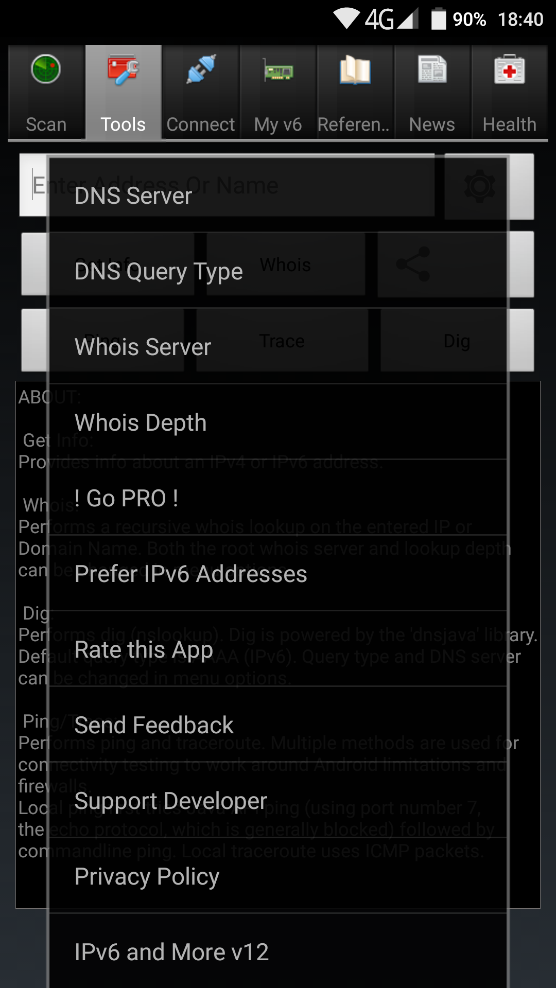

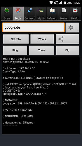

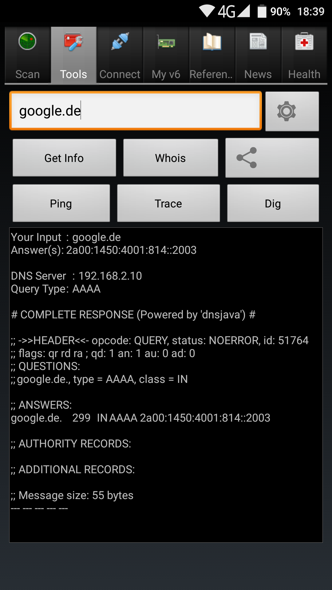

Afterwards, chose a valid domain and click on Dig. If everything works out you should see something like the following (note the QUERY status: NOERROR and that there is a result under ;; ANSWERS:).

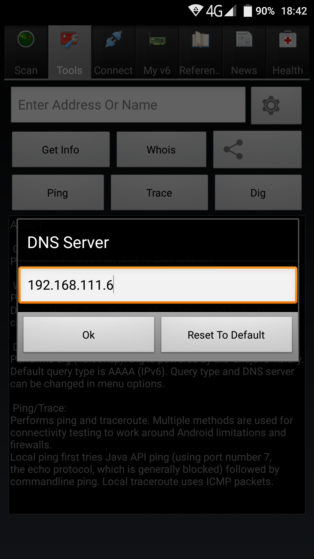

Awesome! What I am not understanding - is - why my router is not having the wireless clients use the Pi as a DNS when I specifically enter that into the settings. I will have to do what you specified above for each device - therefore - it will not be network - wide, right? I will get the program later today for our debugging.
I think the app will only configure the server it will use for its own testing, not for the whole system. If it is your router that is preventing you from setting the DNS server network-wide, you might want to consider using the Pi-hole DHCP server.
I gotcha. However, if we do that, my port-forwarding and such I have set up on my router will then no longer function, right? I downloaded the program, and it looks slightly different from yours - it has no option to put in DNS server. I checked, and my default is still the Pi. I put in Google.de and the response was "Timed out waiting for response. Retry the query" I tried Ping from this program and it worked fine from my wireless to my Pi on the Wired net. Also, if I do use the Pi DHCP server, will that al;so work for the wireless if I go in and disable DHCP (and I would have to do that for both nets, right?)
