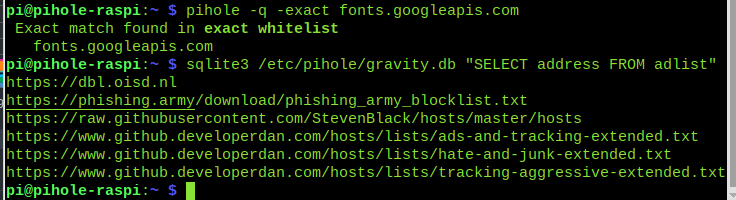

Upon further observation and investigation I have found that fonts.googleapis.com is not reachable on any device and breaks many websites.
This is not a domain that appears on many blocklists (not on the Pi-hole default list, for example).
You can whitelist the domain, and this will prevent it from being blocked by any blocklist.
But, of more interest, let's see why this domain is being blocked. From the Pi terminal, please post the outputs of the following commands:
pihole -q -exact fonts.googleapis.com
sqlite3 /etc/pihole/gravity.db "SELECT address FROM adlist"
i have had it whitelisted for a while but from time to time, not sure why, but that will cause the death a multitude of websites for 10mins to 3 hours. I have no idea why it happens.
Please advise on what else you need and thank you. at this time only the default ad list is being used due to the problems i have been having.

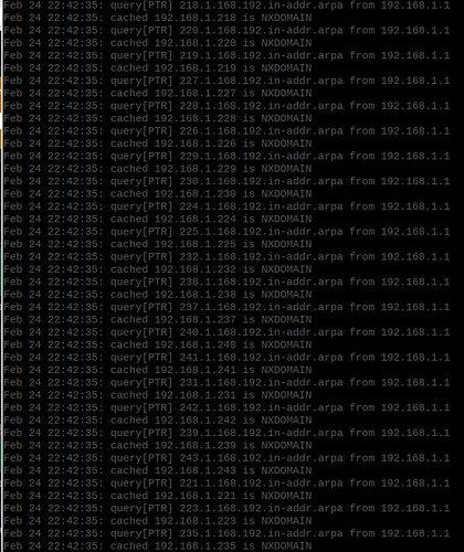

Moreover, i have notcied strange behavior from the pihole -t it will continually run show this. most of those IPs in the 192.168.X.X are not even used:
Again thank you for any and all advice!
