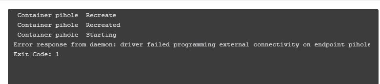

I removed mine and tried the one from the link. Something is stopping it from compiling. Sorry, but it’s beyond my understanding.
This is a Docker message, so you'd need to consult Docker's documentation and support.
That said, there is no compiling involved when starting a container.
Docker is just configuring the container according to configuration options as supplied by you (in this case, via your docker compose file).
You've clipped the message, but I'd wager that Docker complains about port 53 already being used.
To address that, you want to make sure that no other process is listening on Pi-hole's required ports (53 and 8088, according to your compose file).
In particular, you should verify that Docker isn't still running your previous Pi-hole container.
Check with docker ps --format '{{.Names}} {{.Ports}}'. Once any any previous Pi-hole containers have been cleared (e.g. by docker stop <container-name> and docker remove <container-name>), start your new container.

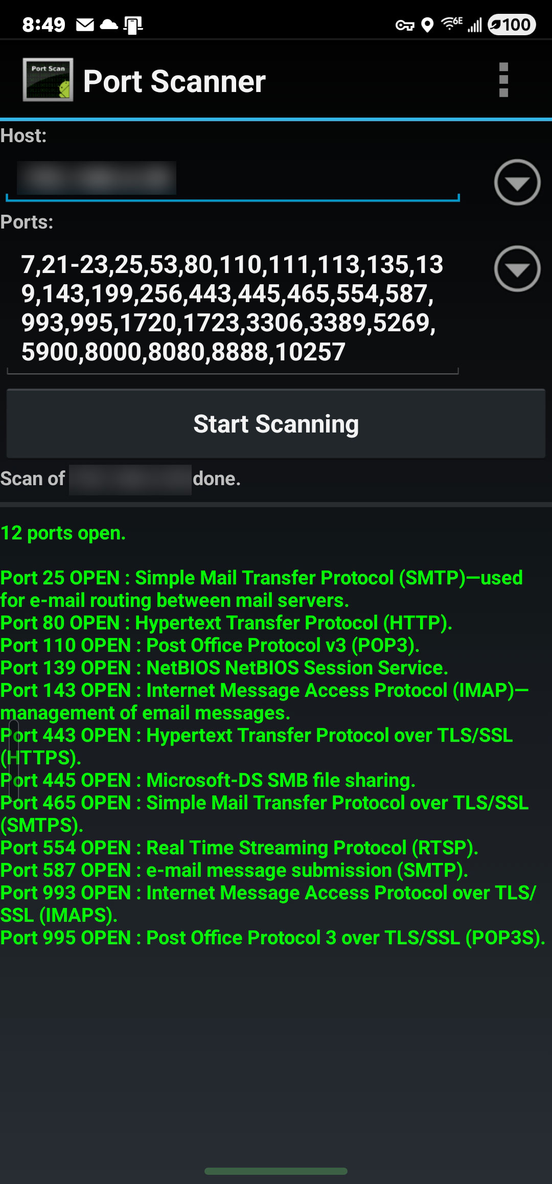

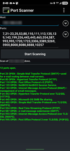

I didn’t clip the message, that is the whole message window which can’t be expanded. My pihole container was stopped and remove.
I scanned the open ports on my synology, port 53 is not shown as open. Also, if you look back at my initial container the exact same ports are used including 53 and 8088.
Then you need to ask for help on the Synology forums or on Docker forums. This message simply doesn't explain what is wrong.
You are mixing things.
No one said your ports were opened or blocked.
Bucking_Horn said that is possible that another service (on your server) is already using port 53.
Only one service can use a port at a time.
If there is another service using port 53, the container won't start because it needs this port.
Please run this command on the host (your Synology) and post the output:
sudo ss -tupln '( sport = 53 )'
OK, figured out my mistake and got it up and running. What’s my next step or is the new yaml also linking it to the Tailscale clients?
