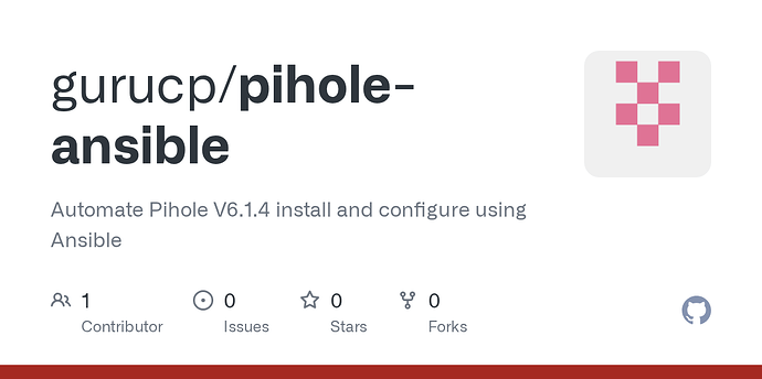

Pihole autoinstall using Ansible
Created an Ansible playbook to automate the installation of Pi-hole and configure the add block repos, configure fine-tune nftables, performance optimization using unbound DNS, and a few kernel parameters.
Please review this and give your feedback
GitHub repo link:
