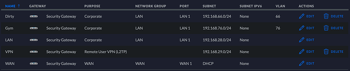

I know this is a non-standard setup and a multi-disciplinary request, but I'm trying to get my PiHole to serve DHCP addresses (and, after that's working, resolve / block DNS queries) on multiple subnets which are on multiple VLANs. My plan is:
✅ Create L3 VLANs on switch (VLAN66)
✅ Establish virtual interface eth0.66 for VLAN on Pi

Systems:
Ubiquity UniFi setup (USG, SW-8s, AP-Pros)
PiHole on Pi 3b, wired
