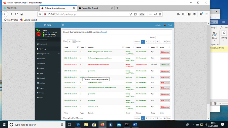

laptop on lan receives dhcp from pihole

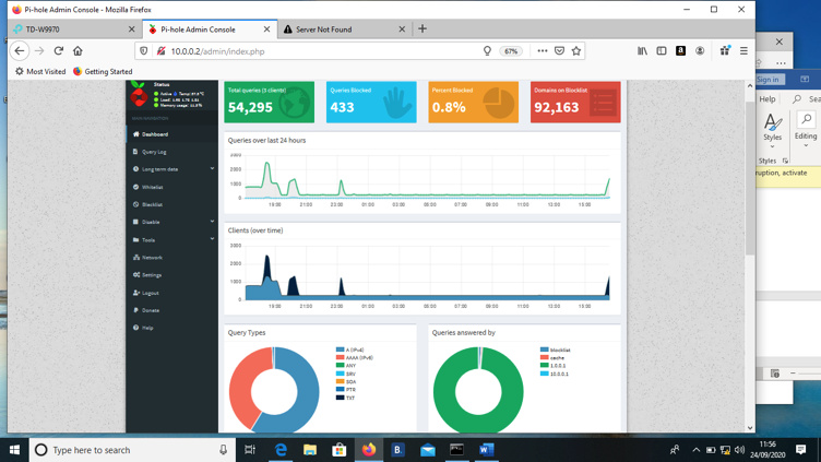

pihole appears to be be receiving the dns queries but not replying back to pc with response.
external network routing test
ping to 8.8.8.8 works perfect so network routing is there
ping to bbc.co.uk shows in pi logs but no reply to PC
similar web browse to bbc.co.uk does not resolve.
