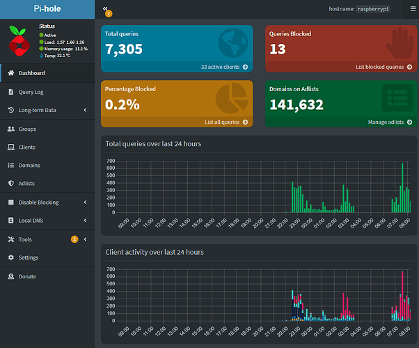

Pihole appears to be active, but many ads aren't being blocked
Ads should be blocked when I visit any website
Ads are not being blocked. Tested on Youtube.
I was initially not able to get the DNS Server changed on my router, so I set up the Pihole as the DHCP Server as well and turned off DHCP on the router.
Based on what I can see in the console, queries are being logged and there are active Clients. but I don't see any ad requests being blocked, and websites are still displaying ads.

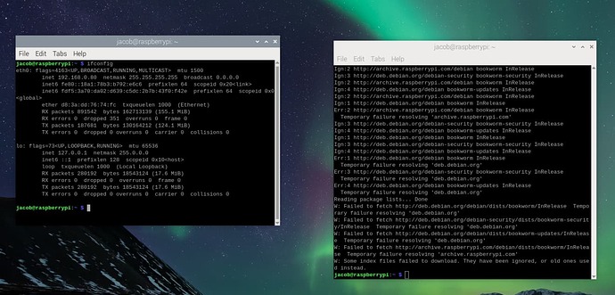

Not sure if it's related, but I am unable to finish a sudo apt get update on the Pi itself.
Pi-hole will not block ads on YouTube. Pi-hole is a domain blocker, and the YT ads are served from the same domains as the content.
I see, that is good to know. thank you. I'll continue to use Brave Browser for YouTube.
What about Streaming sites, such as ParamountPlus or HBOMax. Will pihole block ads there?
I mainly want to confirm that the pihole is functioning normally. I had thought that it'd be blocking many more ads than 2.5%
Note:
This percentage doesn't mean Pi-hole is blocking 2.5% of all ads.
This means Pi-hole has blocked 2.5% of all DNS queries it received.
Blocking 100% of the queries would mean no internet at all. Most queries are not ads.
Did you intend to have two different IP addresses assigned to the eth0 interface on your Pi?

Your Pi-hole instance isn't currently blocking anything.
