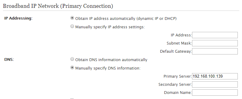

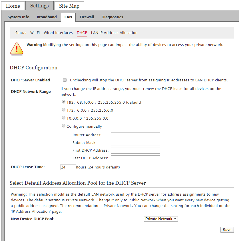

What DNS servers are configured in your router in the DHCP settings?
What DNS servers are shown in use in the iPhone- settings > WiFi > click active network > configure DNS
In my iPhone the dns server is automatically set to 192.168.100.139. As for my router,
And for my DHCP settings I believe I'm limited to this.

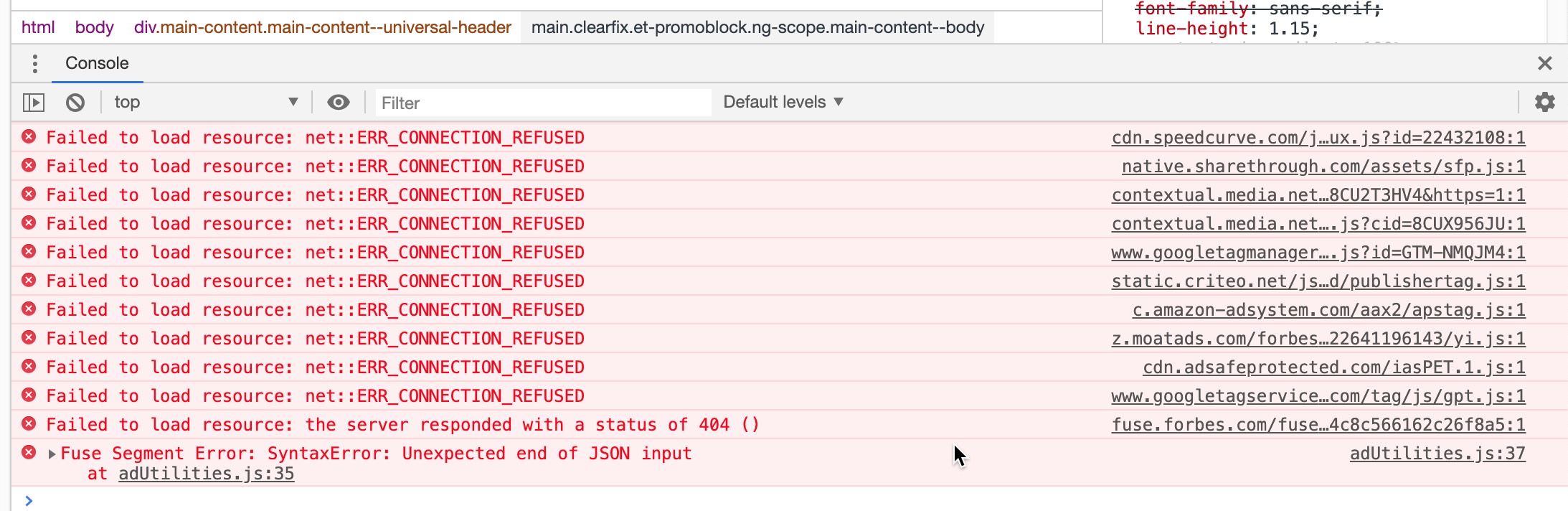

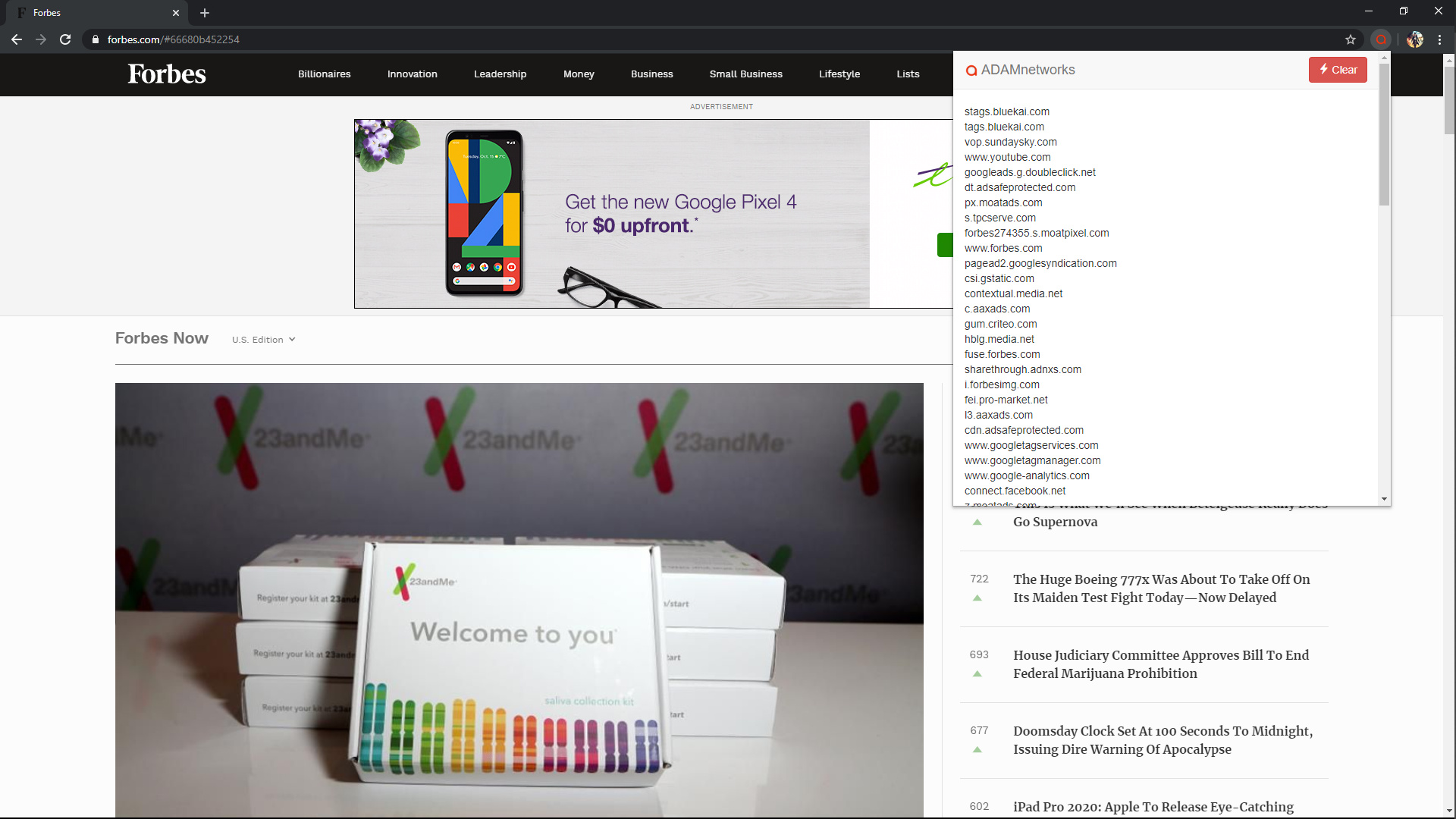

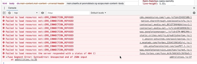

What are the tools in the link provided above showing you? Use these tools on the Forbes site. I see no ads there on an iPad.
When going into the forbes site I get this using the extension

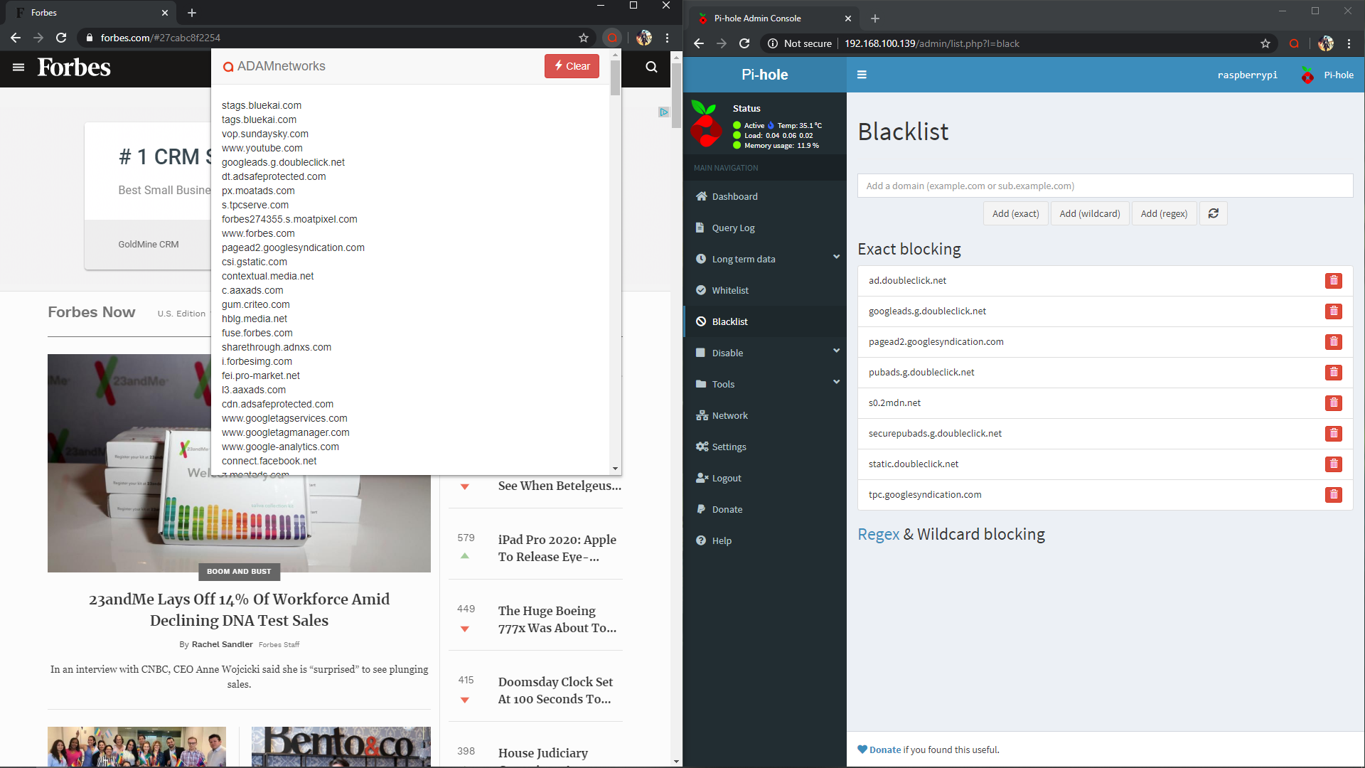

Here's one using the live query.

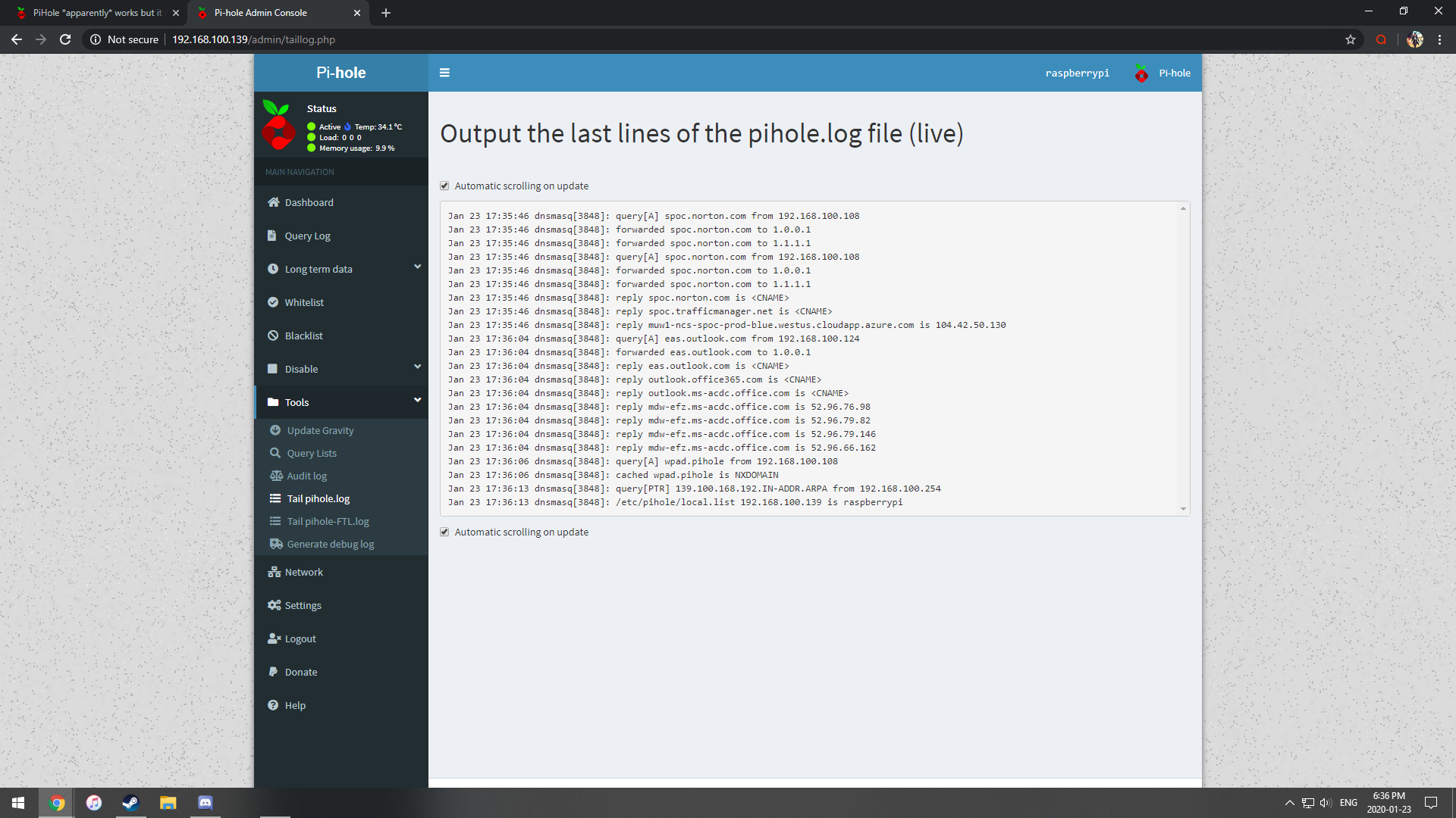

Notice that many of the requested domains are not seen by Pi-Hole? The DNS queries are going elsewhere. What browser is that being used?
Use the web inspector to find the URL of the banner ad, and see if that domain was seen by Pi-Hole.
For comparison, on IOS using Safari browser with no adblocker, and Pi-Hole for DNS; the following activity was seen in the query log when forbes.com was opened. The output may look different because this was run on the v5.0 beta which has some log changes but the same functionality. Blocked comains are shown with ::

From MacOS Chrome with no adblocker active, using a Pi-Hole V4.x as DNS server, here is the pihole log:
Jan 23 19:17:00 dnsmasq[19919]: query[A] forbes.com from 192.168.0.135
Jan 23 19:17:00 dnsmasq[19919]: forwarded forbes.com to 127.0.0.1
Jan 23 19:17:00 dnsmasq[19919]: reply forbes.com is 151.101.194.49
Jan 23 19:17:00 dnsmasq[19919]: reply forbes.com is 151.101.130.49
Jan 23 19:17:00 dnsmasq[19919]: reply forbes.com is 151.101.2.49
Jan 23 19:17:00 dnsmasq[19919]: reply forbes.com is 151.101.66.49
Jan 23 19:17:00 dnsmasq[19919]: query[A] www.forbes.com from 192.168.0.135
Jan 23 19:17:00 dnsmasq[19919]: forwarded www.forbes.com to 127.0.0.1
Jan 23 19:17:00 dnsmasq[19919]: reply www.forbes.com is <CNAME>
Jan 23 19:17:00 dnsmasq[19919]: reply g2.shared.global.fastly.net is 151.101.186.49
Jan 23 19:17:01 dnsmasq[19919]: query[A] i.forbesimg.com from 192.168.0.135
Jan 23 19:17:01 dnsmasq[19919]: forwarded i.forbesimg.com to 127.0.0.1
Jan 23 19:17:01 dnsmasq[19919]: query[A] thumbor.forbes.com from 192.168.0.135
Jan 23 19:17:01 dnsmasq[19919]: forwarded thumbor.forbes.com to 127.0.0.1
Jan 23 19:17:01 dnsmasq[19919]: query[A] cdn.speedcurve.com from 192.168.0.135
Jan 23 19:17:01 dnsmasq[19919]: /etc/pihole/gravity.list cdn.speedcurve.com is 0.0.0.0
Jan 23 19:17:01 dnsmasq[19919]: query[A] native.sharethrough.com from 192.168.0.135
Jan 23 19:17:01 dnsmasq[19919]: /etc/pihole/gravity.list native.sharethrough.com is 0.0.0.0
Jan 23 19:17:01 dnsmasq[19919]: query[A] contextual.media.net from 192.168.0.135
Jan 23 19:17:01 dnsmasq[19919]: /etc/pihole/gravity.list contextual.media.net is 0.0.0.0
Jan 23 19:17:01 dnsmasq[19919]: reply thumbor.forbes.com is <CNAME>
Jan 23 19:17:01 dnsmasq[19919]: reply g2.shared.global.fastly.net is 151.101.186.49
Jan 23 19:17:01 dnsmasq[19919]: reply i.forbesimg.com is <CNAME>
Jan 23 19:17:01 dnsmasq[19919]: reply n2.shared.global.fastly.net is 151.101.186.49
Jan 23 19:17:01 dnsmasq[19919]: query[A] www.googletagmanager.com from 192.168.0.135
Jan 23 19:17:01 dnsmasq[19919]: /etc/pihole/gravity.list www.googletagmanager.com is 0.0.0.0
Jan 23 19:17:01 dnsmasq[19919]: query[A] fuse.forbes.com from 192.168.0.135
Jan 23 19:17:01 dnsmasq[19919]: forwarded fuse.forbes.com to 127.0.0.1
Jan 23 19:17:01 dnsmasq[19919]: reply fuse.forbes.com is <CNAME>
Jan 23 19:17:01 dnsmasq[19919]: reply d.sni.global.fastly.net is 151.101.186.133
Jan 23 19:17:01 dnsmasq[19919]: query[A] static.criteo.net from 192.168.0.135
Jan 23 19:17:01 dnsmasq[19919]: /etc/pihole/gravity.list static.criteo.net is 0.0.0.0
Jan 23 19:17:01 dnsmasq[19919]: query[A] c.amazon-adsystem.com from 192.168.0.135
Jan 23 19:17:01 dnsmasq[19919]: /etc/pihole/gravity.list c.amazon-adsystem.com is 0.0.0.0
Jan 23 19:17:01 dnsmasq[19919]: query[A] z.moatads.com from 192.168.0.135
Jan 23 19:17:01 dnsmasq[19919]: /etc/pihole/gravity.list z.moatads.com is 0.0.0.0
Jan 23 19:17:01 dnsmasq[19919]: query[A] cdn.adsafeprotected.com from 192.168.0.135
Jan 23 19:17:01 dnsmasq[19919]: /etc/pihole/gravity.list cdn.adsafeprotected.com is 0.0.0.0
Jan 23 19:17:01 dnsmasq[19919]: query[A] www.googletagservices.com from 192.168.0.135
Jan 23 19:17:01 dnsmasq[19919]: /etc/pihole/gravity.list www.googletagservices.com is 0.0.0.0
The Chrome web inspector shows the following items which failed to load (they were blocked):

The domain was not spotted. It's from googleadservices, by googlesyndication. Does that mean I should add it in the block list?
Just noticed something, just saw an ad's domain that should've been blacklisted but was not. Before asking for helping I had blacklisted ads from googlesyndication but just recieved one. Could there be a conflict?
And for my blocklist I just added dbl.oisd.nl and that's about it.
